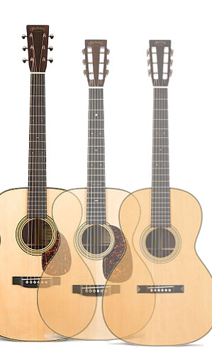

Martin makes a 12-fret 24.9 scale with an OM body, called the Norman Blake. John Hall might know particulars.
Here's a composite image I worked up a few months ago comparing from the left, the OM, Norman Blake, and 12-fret 000.
PostPosted: Mon Sep 24, 2007 9:54 am
Oops.
Here's the image.

Thanks Burbank,that`s exactly what I`m talking about with the bridge being pushed back.I guess I`m good to go to build similar to the center guitar in your picture ,except with a cutaway.If you haven`t played a 12 fret with a 24.9 scale ,it`s a real treat.

The centre guitar which is the Norman Blake model has a 19 fret fingerboard.

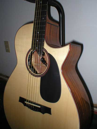

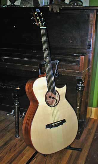

In March, I finished a guitar which is very similar to the one you are planning.
This instrument was designed to shorten the reach of my left arm & hand. (Carpal tunnel & tendonitis make playing a longer scale, 14 fret guitar a numbing AND painful proposisition)
To shorten the reach to the first fret I used a 24.9" scale length & moved the soundhole & the waist up as far as I could without ruining the aesthetics of the instrument. The fingerboard projects well into the soundhole to get 21 frets.
It was designed to be a Venecian cutaway, but a cranky piece of Sapelle insisted that a Florentine was going to work out better (CRAAACKK!)
Moving the soundhole up, gave me lots of room to widen the X brace angle & get the bridge location looking "right". I also widened & lengthened the lower bout to achieve the volume & bass I was looking for.
This guitar turned out really well, feeling & sounding excellent. I can play this guitar for more than an hour with no ill affects to my poor old hand & forearm.
Ten minutes with my old (14 fret) OM & I'm done in!
I like the design so well that I'm building two more now & expect to make more in the future. I've had many comments on how comfortable this guitar is to play... And not just by old f**ts with gibbled hands.

PostPosted: Wed Sep 26, 2007 2:55 pm
Here are the pics that Daniel M sent.
Very nice instrument, Daniel. Just might be what I need. Maybe I'll do a 24.9 scale 12-fret L-00. Something with that short reach would be just the ticket.
