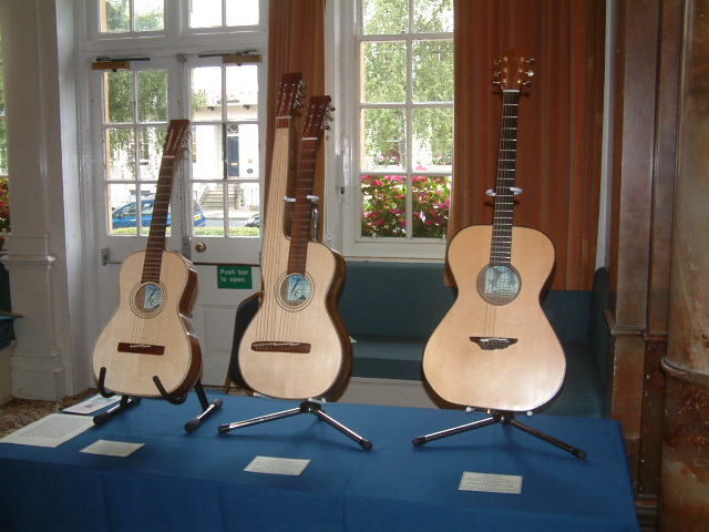

If I use Tru-oil on a top now I do put it over shellac seal coats ... BUT . . . this baritone (far right) had Tru-oil applied direct over three and a half years ago, and if you think the tops vibration has been adversely dampened then check out this sound clip. All finishes penetrate to some degree and if applied in thin coats, Tru-oil doesn't penetrate any deeper than shellac imho (based on some repairs and re-finishes I have done). I now use Tru-oil over Z-Poxy on my necks and like the result very much.
