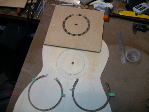

Well, after my last post on rosette and top, I was convinced to use the German Spruce I picked up from The Zootman at the last Swap Meet. So I joined up the set.

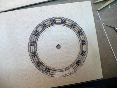

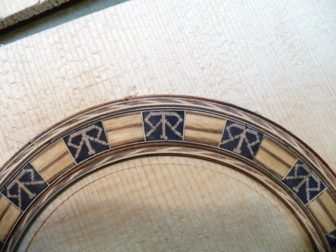

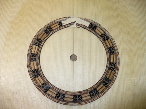

Also, after the last Rosette thread, I made some minor changes to the rosette.  Here it is in Dry assembly - everything a different thickness.

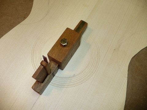

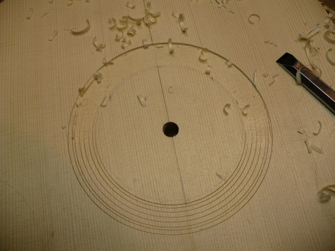

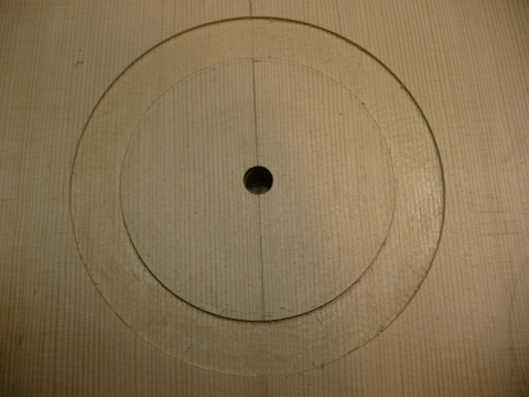

Top joined and cut to size, I slotted the rosette circle with my circle cutter.  I decided that keeping the depth of the cutout even would be easier if I had slots all the way across at the same depth.  Cut till the slots are gone.  All even.
When disassembling the dry assembly, things blew up a little, and I had to replace a few lines, but all pulled together and staged for assembly.

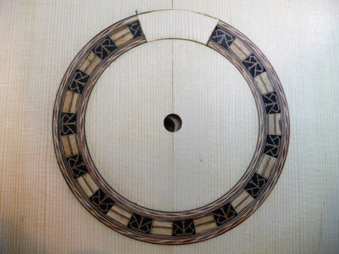

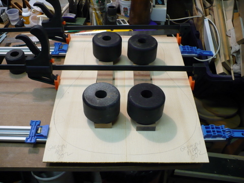

Gluing up, and finished gluing.

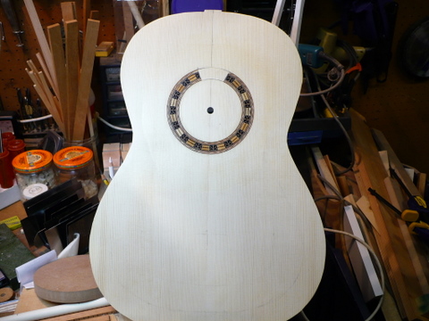

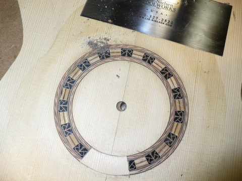

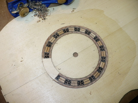

Glue dry and wedge placed in area where fingerboard will be, and planing of rosette has begun.
After planing until close to board, scraping to get down to board surface.

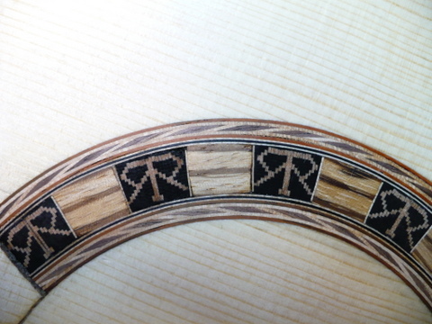

Close-up.  Not perfect, but passable.

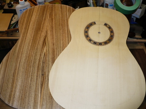

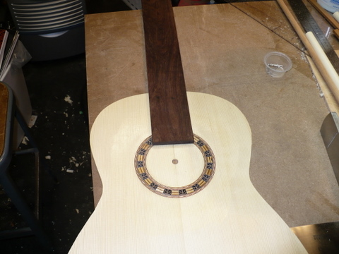

With BRW Fingerboard, and another with the back.

Wow, Waddy, that came out nice, and a fine tutorial, too. The rosette turned out beautifully, I really like it.
A tip for removing the dry assembly: Clear duct tape. Once the rosette is assembled dry put clear duct tape on the top of it. You can then remove the whole rosette without it coming apart. Put your glue in the final resting place and install the rosette. When it is dry, just peel the tape off.
PostPosted: Sun Sep 23, 2007 1:55 pm
Thanks, Hesh.  It came out OK, but unfortunately, in wet/glue assembly, it did not come out the same as it did in dry assembly.  I would have aligned it differently.  I don't know if it was from the glue swelling stuff or that the wet assemly area was slightly smaller than the dry assembly layout when it was staged for assembly.  I suspect the latter.

Good tip Ron.  I'm not sure it would have worked for me though, since some of my strips of veneer were higher than others.  I kept the BRW pieces aroung 3 - 3.5 mm because when they were too thin they would split to pieces.  I figured if they were high, after gluing they would hold together better.  So, I had lots of different heights of material.

waddy, that looks great my friend. as i knew it would. im really excited to watch your guitar come together. i think that your personality type, work ethic, skill, and creativity are going to make for a great sounding and looking guitar. good job. i like how you used your circle cutter to make concentric same-depth cuts across the width of the rosette channel. thats pretty slick man. makes for a nice even depth when you chisel out the waste. of which, i will say that chiseling out by hand is pretty slick in itself.

Well done Waddy, I concur that the final choice of the Euro top was the right one, you won't regret it. Nice work on the rosette as well, now that's the way that a rosette channel should be cut, it's very satisfying isn't it, and I find just as quick.

Thanks everyone.  It was a great experience.  When still rough, it looked pretty cruddy.  Couldn't see the smaller lines very well.  When I got down to scraping, you could see the details appear.  It was a lot of fun, but there was a lot of stress cutting into that new top.  Something made me want to just live with the 3/8" sound hole from the drill, and bypass the rosette installation.

I wish I had laminated even some of mine together.  The thin w/b/w pieces and the strips on either side of the rope could have been done easily, and it would have made assembly much easier, I think.  Though, when I think about it, it might not have been as forgiving when pressing in the tiles.  I also wish I had glued the little .3mm strips to each side of the tiles first.  Those were a pain.
