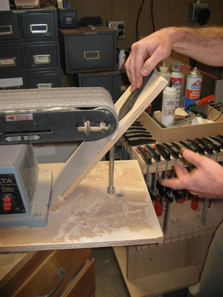

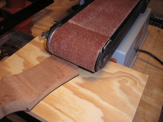

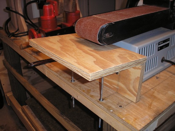

Well,I finally got to making one of these jigs that John Mayes uses on his videos. It worked well on my headstock and volute thicknessing. I know a lot of us have made this jig and it's good for brace ends.I was wondering what other uses it's real good for? What else do you guys use it for??

Doesn't putting a load like that on your idler drum send the tracking way
out of whack? I've never had one of those little belt sanders, so I don't really
know how sensitive the tracking is, but it seems like it would be rough to
keep the belt running straight. Either that or it seems the drums would have
to be so crowned that they could risk sanding a dish in to your headstock. I
know it would work fine for brace ends, but for something as wide as a
headstock I guess I'm a bit surprised it didn't cause any tracking issues.
Cool.

I built one too out of an old POS craftsman sander I have. It doesn't knock the tracking too bad out of whack.
One thing to take note of though if you build this. Make sure you leave your self plenty of room between the sander and the platform so the headstock doesn't bump into the machine and not let you go in as far as you would like.
Mine works great for acoustic necks, but when I build tele's and the like it is just a tad too short.

Dave, I don't have that type of sander, but I would also use it to shape the wings of bridges.
I use my drum sander for all those sanding needs, like brace ends, bridge wings, head stock smiley volute.
PostPosted: Wed Sep 26, 2007 12:44 am
Thanks Hesh,They're very easy to make with a piano hinge cut to size and a few nuts and bolts.You should make one.
I had no problem with tracking on the headstock thicknessing.
Brock, Yes I already ran into that problem.I moved it a bit to miss the sander base.
Thanks Rod.I also like my "Luthiers Friend" jig for some of these things. I like the fence on it for thicknessing small parts like bindings and braces.
I don't know but maybe someday I'll splurge on a drum sander.

PostPosted: Wed Sep 26, 2007 9:16 am
the crowning of the roller is not really a problem as long as you move the
headstock around a little and then use a block on it after you're done to
flatten it that last little bit.

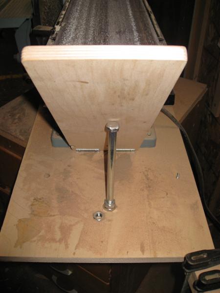

PostPosted: Wed Sep 26, 2007 10:14 am
Posts: 975
First name: Tracy
Last Name: Leveque
State: CO
Here's some pics of one that is a little more simple, but same concept...
Thanks for the great tip John!
