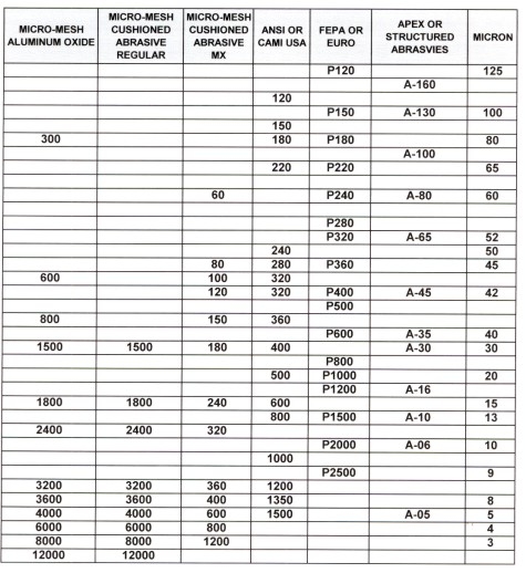

Good point David, and when speaking of MicroMesh there is a third. Here is a comparison chart for MicroMesh to FEPA and CAMI

What David said and Michael's chart. Mixing the two systems can produce nightmares.   Took me a while to figure out what was causing my nightmares.

[QUOTE=npalen] What David said and Michael's chart. Mixing the two systems can produce nightmares.   Took me a while to figure out what was causing my nightmares.
Yeper it will really mess you up as you get to finner papers. Just try to remove CAMI 400 scratches with FEPA 600. Then you suddenly realise you going up in micron instead of down
