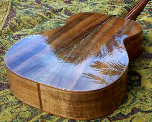

I just finished a guitar with it, it turned out fabulous and the wood was very easy to work with. If you want to see/hear it I posted some sound bites and pics a few weeks ago.

Beautiful Hesh!  I expected to see some black lines running through it.

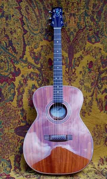

I used Tassy Blackwood on my second guitar. It's so easy to bend, but I found it dulls tools and sandpaper quickly. Also my hands seemed to take on a black stain every time I worked with it. Perhaps why it gets it's name?
Fiddleback acacia bindings and end graft.
I matched it up with a Australian Cedar top that I thought really complimented it.

PostPosted: Sun Sep 16, 2007 7:34 pm
Posts: 1055
Nice top Allen. What species is the Aussie Cedar and where did you get same?

[QUOTE=kiwigeo]Nice top Allen. What species is the Aussie Cedar and where did you get same?
Cheers Martin[/QUOTE]
I got all the wood for this guitar from Berry Kerr. It's suppose to be Queensland Cedar, but I don't know if there is a any difference to Australian Cedar. I suspect its still Toonis Australis, just sourced from Queensland.  I've been trying to get some more, but seems hard to come by in quality sizes for tops.
