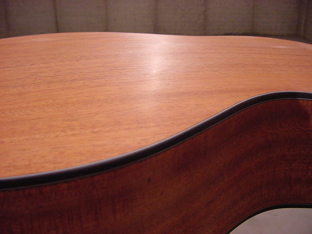

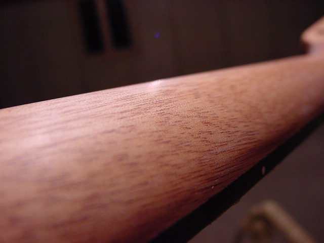

I thought I'd get a new thread going on the pore fill I have going on a mahogany/cedar guitar. I have applied two coats of epoxy and sanded between coats. The first coat was leveled with 400 grit wet paper. Took way too long and too messy. At Ricks suggestion I dug out the DA and cut it down with 500. I did the neck by hand so I could have better control of the cut and speed. It is looking very nice and I have no open pores, just nice level epoxy. Now I have this question for you seasoned West users. I have spots that I cut through to bare wood and wonder if I should spot apply, re-apply to the whole body or just seal the whole thing and spray clear. Rick? You here? Would the McF. rosewood sealer take care of these cut throughs? heres a shot of the leveled back and neck.

Hmmm, the back didn't make it on the first go.
PostPosted: Mon Sep 17, 2007 12:07 pm
Posts: 1398
Cutting through doesn't seem to matter.   The McFadden sealer has the same wetting properties as the epoxy. I wouldn't bother going as fine as 500; use 280 or 320 and get the job done faster. That will also give a bit of mechanical bite for the sealer.
PostPosted: Mon Sep 17, 2007 12:28 pm
Posts: 404
Thanks Rick! That's just what I was concerned about, whether the sealer would wet the wood uniformly. I am surprised that we can get away with 320 or even 280! In automotive, the lowest we could go is 500 on a mechanical orbit, even then we had to be careful. I guess these epoxies and polyesters can actually fill the abrasions far better than the catalyzed urethanes. I like this West stuff!
I tell ya' what else. I LOVE the neck just in sanded epoxy alone! It feels very nice and playable. Thanks for the input too Hesh! Y'all rock!
