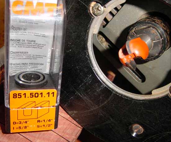

There was some discussion in JJ's thread about which router bit to use. Rick had revised the plans by the time I got my copy and this is what is now recommended.
It's a 3/4" tray cutting bit.

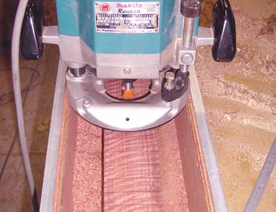

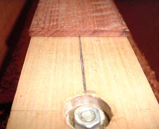

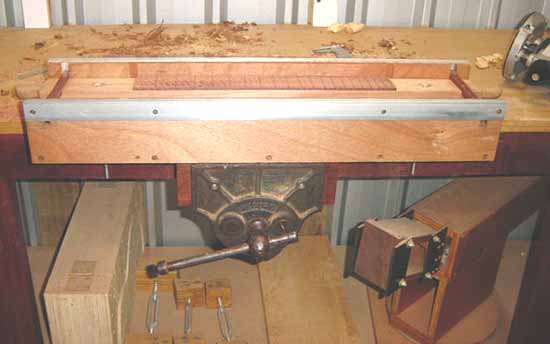

It seemed to me that some in JJ's thread were a little unclear on how this jig actually worked so I took some images to try and clarify a few things and a closer image of the carriage block bearing assembly and radius guide just held together by hand so those interested can have a closer look. If you read JJ's thread, he explains the process very well and these images are just to focus on the details of the system and to act a a supplementary to his post.
Basically the slotted fretboard is secured to a carriage board using double sided tape. The carriage board is held static under spring tension onto a pair of exchangeable radius profiles which are slotted into rebates let into the sides of the jigs main structure.

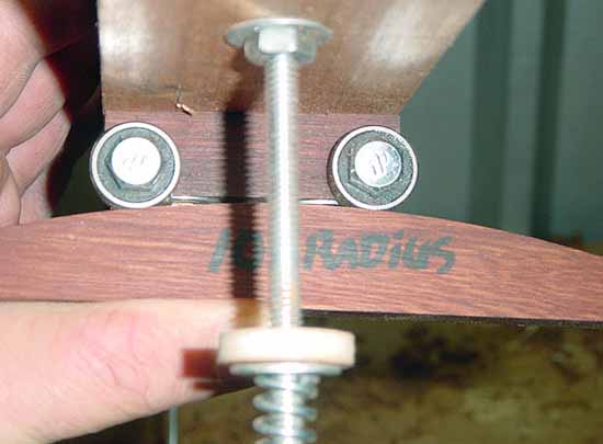

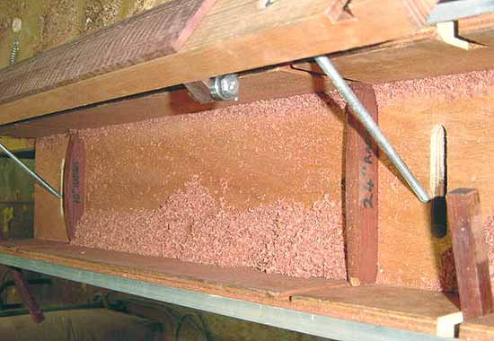

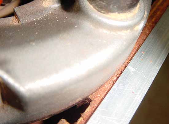

The router is held in track by the 2 aluminium guides which can be seen in the image displayed below. The router is progressed along the jig between these 2 aluminium guides and passes over the fretboard completing a pass.
Once a pass has been performed, the user then makes a small incremental advance of the carriage board over the pair of radius profiles at the very base of the jig. The carriage board, which is fastened to bearing blocks located at either end, rides across the selected radius profiles upon bearings which in theory results in the desired radius being reproduced into the surface of the fretboard.

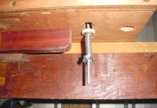

The above image also shows the carriage tension system and the UH plastic washer which allows smooth advancements of the carriage board to be made when required. This is the guts of the system as it holds the carriage board secure and allows you to keep both hands on the router during each successive pass.

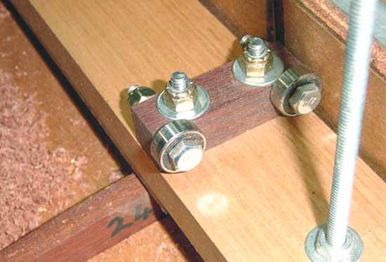

A closer look at the bearing block.
And the spring loading mechanism when in place on the jig.

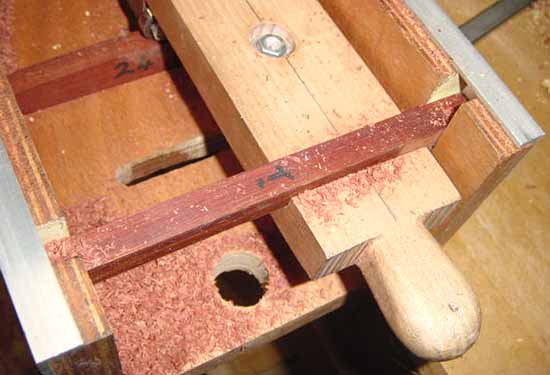

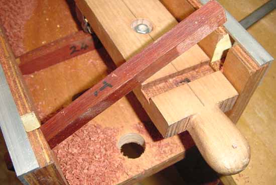

The carriage board is also prevented from moving around during a pass by two hardwood guides or stabilizers which are let into corresponding rebates cut into each end of the carriage board and those into main structure of the jig itself.
To ensure smoothness in operation of the router along it's path, a gap of app 1/16" left between the router base and the guide rails of the jig.
This should be the only play in the jigs operation and for best results should be considered in operation with the user making a first pass bearing lightly upon one side of the jig, and a returning pass bearing upon the other.

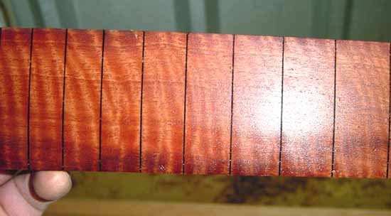

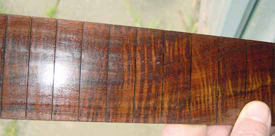

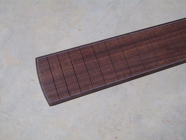

As can be seen here in the images below the end results are very good for a single cut radius. These are end shots of 2 different fret boards the lower one is a 16" profile and checks perfect with those little stewmac gauges.
As I mentioned above, in theory this jig will cut the same radius as the profile which is inserted into the rebate. If this were so in practice, this jig would be ideal for making a compound radius fretboard. However unless I done something wrong in putting my jig together, this has not proven to be the case in practice.

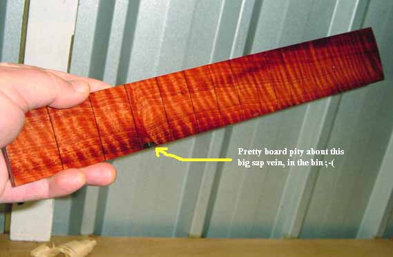

Even if this one did end up in the bin But that was not the jigs fault, it was heading there anyway due to a big fat gum vein.

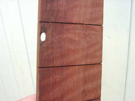

Can any of our members outside of the Australia tell us what kind of wood this is pictured above??

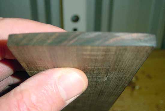

Or what kind of wood this is pictured below??

Is that first fingerboard curly Jarrah?
That sap pocket looks like an opportunity for an inlay! I know that gorgeous wood "shouldn't" need any inlay to dress it up, but maybe you'll be able to think of something - possibly even dressing it down. For instance, one of the members here (can't think of who) did a series of seasonally themed guitars, and had wooden Fall leaves inlaid into the fingerboard (and wrapping over onto the soundboard.)
When you say "bin" I hope you don't mean trash bin, but maybe at worst scrap bin, waiting for a use.

No need to lose that fretboard! if the pocket is too soft, dig out the sap, and fill it wit an epoxy sawdust mixture. The trick here is to leave a natural, rough edge around it when digging it out. if the surrounding area is too nice, it will look like a fix, if you leave it looking naural, it looks, well, natural.

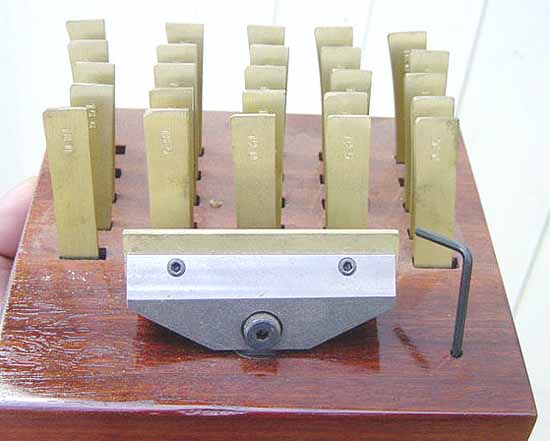

One question. Since the fretboard sits almost 2 inches higher than your 10’ radi template, wouldn’t that mean you are cutting a 12 inch radi into the board?

Mario, Kim's just teasing us by throwing out that fretboard. That stuff grows on trees in his neck of the woods. I could hazard a guess as to what it is but I won't.
That second fretboard looks kinda familiar. Tho, my pic doesn't show as much figure, it's actually about the same as Kim's. The bucket of lard will have to go to one of you foreign types.

OK, so Dennis grabs the lard for naming the first board, it is indeed Jarrah. As is the bench, all the hardwood components of the jig, and everything else around here that needs to be made strong, stable, and durable, even my old house is all Jarrah framed, the whole thing, studs, noggins, joist, purlins, window and door frames, everything. Even the floors are Jarrah and she's clad with Jarrah weatherboards.
I must admit she does look a bit of a basket case now days but she's still solid and strong in any storm even though she was put together on this site in 1951 from bits and pieces of buildings that where bought down from the Murchison gold fields first constructed up there at Reedy's Gold Mine in the 1850's, yep, Jarrah is good wood
I think Paul has shown that he is onto the second board but mine is the western variety from out around Coolgardie and is apparently a little different from the rest found in AU, both very nice though.
Mario, the sap hole in the Jarrah board is quite large, one could fill it or make a feature I suppose, but it will always be noticeable. The board is also a shorty only being long enough for 20 fret, so it was always a target for experimentacion, I needed wood, it got too close .

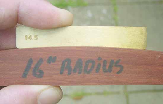

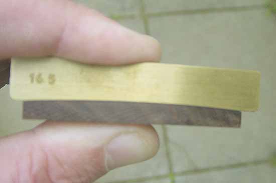

Wade, your not missing anything mate, in fact your spot on with your observation. It appears that Rick has made allowances for the increased radius that the carriage board is forced to follow over the radius profile by decreasing the actual radius of each marked template that is provided with the plan.
To demonstrate this I have used a couple of the very accurate fret caul insets from the set that I got from John Watkins of CNC Guitar Parts, he's a member here at the OLF so PM him if you need some of these high quality tools....Oh yeah, the holder is also Jarrah
Anyhow, as you can see here the radius profile marked as 16" is in fact 14.5", this was probably meat to be 14" but I probably got a touch over enthusiastic when shaping
So the result of using this profile in the jig is actually a 16.5" radii but that's OK, at just a couple of thou difference, Ill take it.
