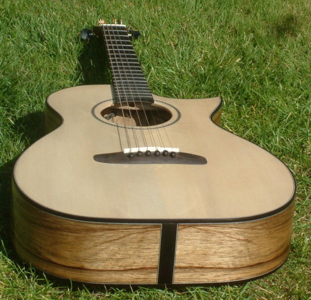

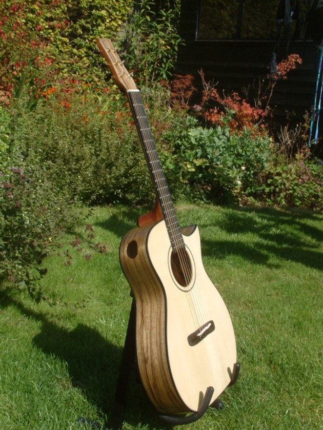

Sam Price has already posted some pictures of this guitar on the Cheltenham Guitar Show thread, but I thought I'd give it it's own thread in honour of Zootman Bob C's wonderful Black Limba. I built this very quickly - starting in the second week of August with a view to having it for sale at Cheltenham but Suzy fell so in love with it that I couldn't sell it and now have it as a demonstration guitar (cared for by a certain person ). Also it's not in line with what I do - I like to make comissions for people that are bespoke instruments rather than making and then trying to sell.
The fit and finish leave a little to be desired as it had to be made in a hurry - mainly the mitres around the cutaway area - but soundwise I am delighted. It very quickly became a Florentine cutaway model when I had a slight mishap bending the first side . Ok some details:

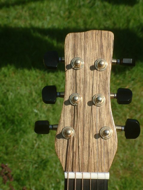

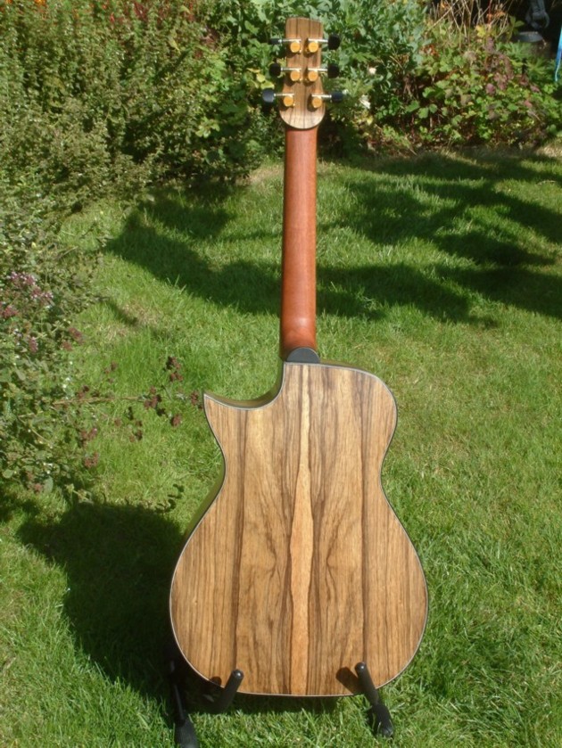

It is based around my Samhain Grand Concert model but I wanted to try what is (for me) a shorter scale length of 630mm (24.8") and I decided to make it a 13 fret body join as that seemed to fit. The top is Euro spruce with Black Limba b/s and mahogany neck. Binding is ebony with bwb side and top/back purfling, fingerboard and tail wedge are ebony, bridge is Old Rio Rosewood with ebony pins, and the headstock front and back veneers are Black Limba. Tuners are Gotoh with ebony buttons. The back is my X brace/ladder hybrid and the top is my usual bracing pattern but is the lightest bracing I have gone with so far. It has the cf flying buttress braces and free floating neck. Finish is two coats of pre-catalysed lacquer (over Z-Poxy on the b/s) and Tru-oil over Z-Poxy on the neck:

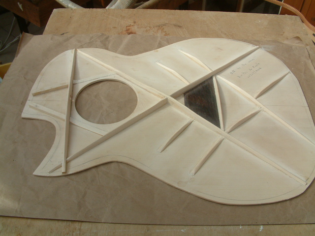

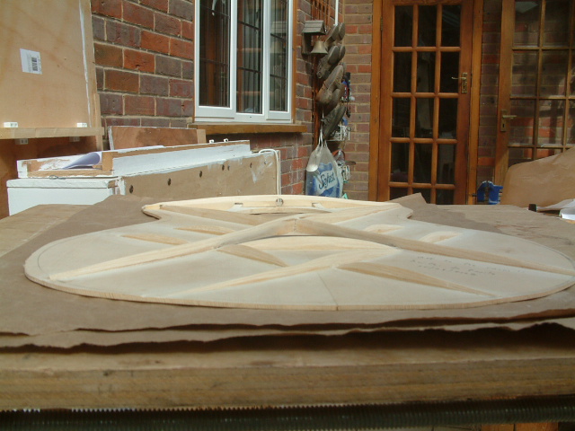

And here's a couple of pictures of the top bracing:

First, the sound hole looks oversize?? This may be an optical illusion, but it seems large for the guitar. Is it larger than 4"?

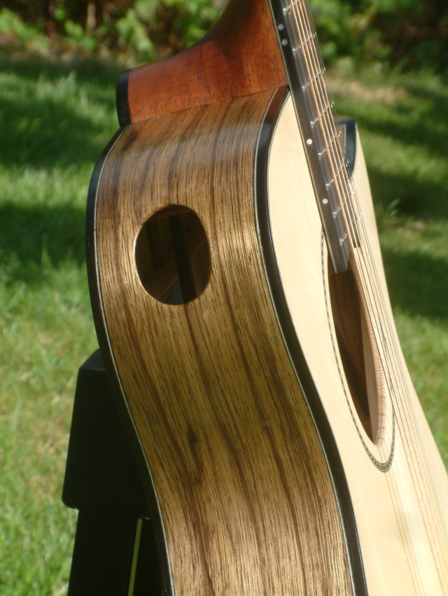

Also, on the 5th picture (looking inside at the neck block) I notice some extra hardware in there (black objects on either side of the neck block). What is it?

Yes - the soundhole is 106mm diameter (4.17"). It is part of my overall design though and goes with the big top arch, narrow X brace angle and forward shifted poition of the soundhole. The larger soundhole helps volume and projection on my guitars.
The "black objects" are the carbon-fibre flying buttress braces that let me do a free floating neck/fretboard and concentrate on bracing all of the top for sound. I learned these techniques from the building of Mike Doolin, Rick Turner and Howard Klepper. I just smile quietly to myself now when I read statements to the effect that the guitar's upper bout is tonally dead You can find out more abot the cf braces here on my website and also look at the guitar-cittern and harp-guitar build photo documentaries there.
