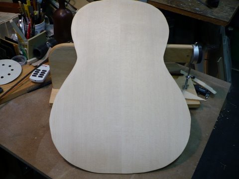

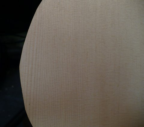

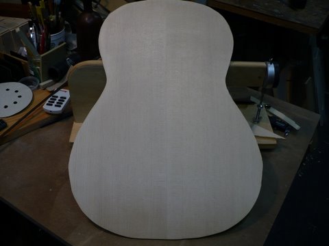

OK, now that I am getting close on my rosette, I get down to my top issues.  I posted some time back, a thread on grain direction, that moved into the runout discussion.  That is still the top in question.  There is definitely some runout, but I don't know if it is significant, or not.  Should I just glue up another top, or work with this one.  This one, has nice ring, and I was told it was stiff when I bought it, but you couldn't prove it by my feel - first top I ever felt in the raw (the top that is ).  Here are a couple of pictures of the top.  I was having trouble getting clear pictures showing the grain, which is dead 90*.   This is AA Sitka as I recall.

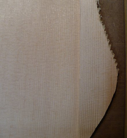

You can see the slight variation in color.  Grain on the right side as you look at it runs top to bottom, and grain on the left bottom to top.  When wiping with a cloth you can feel it.  Also, you can't scrape against the grain very cleanly.  Now, if I use this top, since it is my first build.  Should I make a 4 piece top out of it this way.  Pics of the wings, and the add on possibilities from cut-offs.

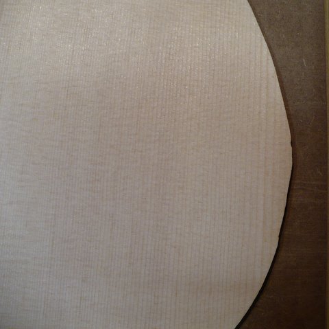

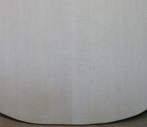

Treble wing:
Bass wing:
I know you can't really tell from pictures, but I would appreciate any help I can get in making a determination of my own.  Scrapping this top is certainly an option.  I have one other Sitka top, several Lutz tops, and one German Spruce top in the wings, any of which I could join up, thickness and cut out.  I tried splitting a piece of this, and it split on an angle at about 15*, but I am not an experienced splitter, so I may not have done it right.  It did do the same at both ends of the stick I was splitting though.  One other thing that could have an effect on that is that it came from the outside wings where the grain is much wider spaced, and not as straight.  I used an old Grill Scraper blade sharpened to a point \/ like that then dulled to a rounded point, to do the splitting.  It worked pretty well on my braces.
Any thoughts you might have on the subject would be a help, and certainly appreciated, except, of course, "Go pound sand!"

As far as the variation in color. Because you are book matching two planks cut from the same billet one will appear a different shade than the other. But notice, if you turn the set around the plank that was darker now appears to be the light one. this is due to the run out of the grain. Unless the top was perfect quartered. which is not likely. This is a normal thing and is not very noticeable under finish unless you are looking for it or have a lot of run out.
