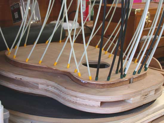

I use a similar caul setup when gluing a top with HHG. I use only about 16 - 20 gobars however. I also have a "dimple" drilled at each location on the caul where a gobar is positioned. This has prevented any gobar slippage. I've used this method on 6 guitars so far.

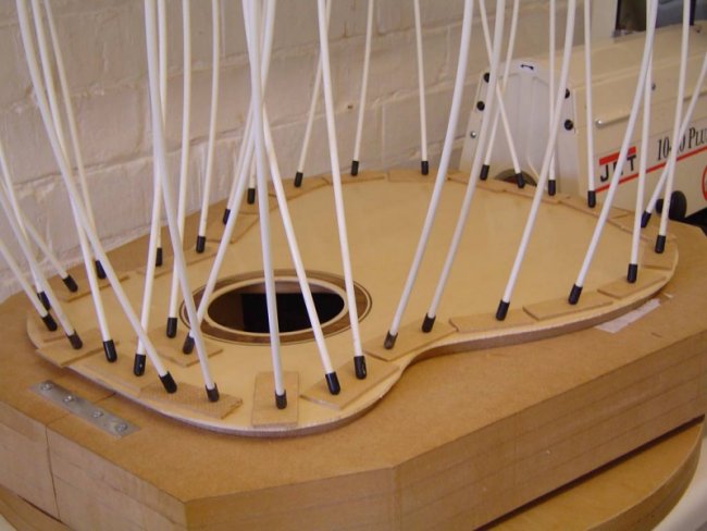

I just use separate bits of hardboard, I've never had a bar slip yet, nice thing is these fit every size guitar I make! I can see the benefits of a dedicated caul though.

I use a scrap top that I got in a Martin reject lot. It's floppy like piece of wet cardboard, so I had no intention of using it. Just one piece, very fast to use and protects the whole top or back in case of a slip.

I have a caul like that too. Mine is made out of 5mm plywood and I glued a layer of cork to the side that goes against the guitar top.

I too use pressed hard board cut to just over shape with the center open to allow the dome to rise through as shown in Todd's picture. But I don't use near that many go-bars More like the amount Colin shows

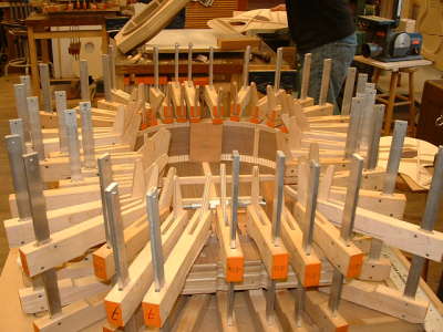

As Bruce mentions, My cam clamps have cork on each face to protect whatever I am clamping. no need for cauls. This is a picture of a back being glued on, but I do the tops the same way.
PostPosted: Fri Sep 07, 2007 2:23 am
Posts: 975
First name: Tracy
Last Name: Leveque
State: CO
I do the same as you Todd, works great! Putting some carpet on the top of the deck helps the top bars from slipping. Nice pic!

Same setup as Todd's, only 1/8" tempered hardboard, 'rough' side down. Only I didn't cut it so neatly, as I eyeballed it with a jigsaw. Cheap and functional.

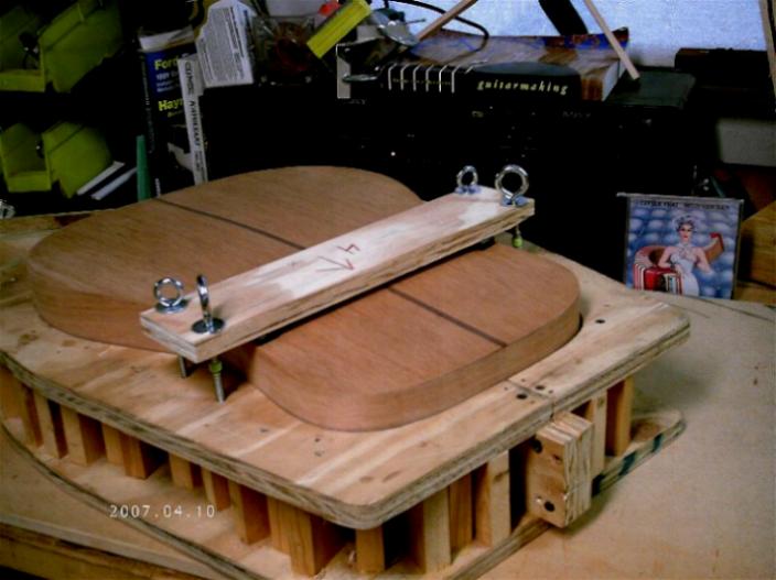

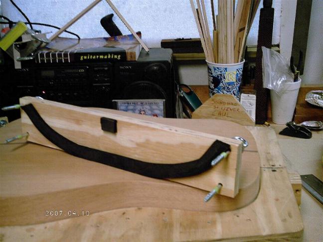

When I made the jump from PVA to HHG, I knew that closing the box was going to be more challenging. Turns out I was right. I originally used a slightly oversized caul with screws ala Kincaid... OK for PVA but too slow for HHG. I then went with the go-bar deck. Still too slow for me, guess I'm just go-bar challenged. I settled on a series of wooden cauls using oversized eyebolts. The clamping edge is lined with 1/2 weather stripping, protecting the wood and thick enough to allow the caul to clear the top/bottom arch. Notice the thin masking tape collar which prevents the eyebolts from falling out of the caul... Important when you're tring to work quickly.
I start out by clamping the wasit first. Once it is tightened, the top/back is pretty much locked into place. The holes in the cauls for the eyebolts are oversized which allows the caul to follow the taper of the sides. The stop blocks are positioned so that only a turn or two of the eyebolt is needed for good clamping pressure.
I then alternate the cauls, working my way toward either end.
I can get all the clamps in place in less than a minute giving me plenty of time to clean up the squeeze-out. It's not as elegant as the go-bar deck but it does work well for me... quick and consistent.
