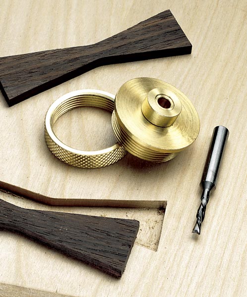

Why not use the jig to also cut the end wedge peice as well? Just seems like it would be much more accurate, not any more work to set up, and should eliminate sanding errors. You'd need to stop at woodcraft and pick up this....

I love the curved wedges too! That's why I looked for a good way to make em too. I tried to post the link but here goes again, for the Woocraft inlay kit

If you wanted to use that woodcraft inlay kit for cutting the wedge you would have to somehow take into consideration the depth of the purfling lines flanking the wedge. Those lines might vary from one guitar to the next depending on the decoration scheme. How could you make the inlay jig adjustable to allow for that variable?

[QUOTE=Terry Stowell]Why not use the jig to also cut the end wedge peice as well? Just seems like it would be much more accurate, not any more work to set up, and should eliminate sanding errors. You'd need to stop at woodcraft and pick up this....
I had thought of how this might be done, but don't have the kit that you have. In fact ,although Cairns is a small city, we are basically at the ends of the earth when it comes to getting anything a little out of the ordinary. You should have see the blank stares I got when I asked around town if I could get some 24" sanding disks for my radius dish. Most everything I have to get mail ordered and shipping gets to be a bit much.
Your right though, it would make the job more accurate, but I would have to be using the same binding on each guitar, or have to use a different collar, or shim it with tape etc. Back to trial and error and more fitting.

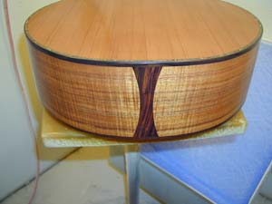

Yeah, I use a similar ststem/jig, to account for the purfling it is a trial and error process but really pretty simple, I just used a few rounds of blue tape on the bearing guide to gain a bit of space( 1 round per cut until the proper width is found). Here is what I ended up with, a nice tight fit. Depending on how you design the jig you can alter the shape of the tail piece as well...adjust the width of the fluting from top to bottom by sliding the jig up or down on the guitar body(and inlay).
