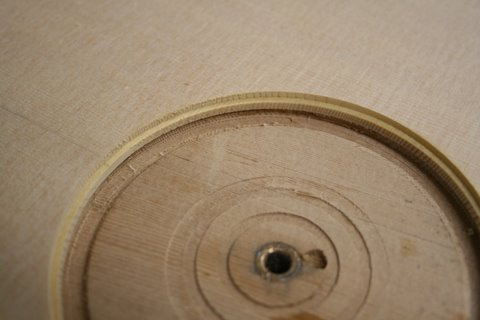

I start out with a soundhole patch. .100" thick cross grained spruce.
Soundhole gets cut with whatever purfling scheme is needed. This is done with a router on a circle cutter and just micro adjusted for the purfling shelf.

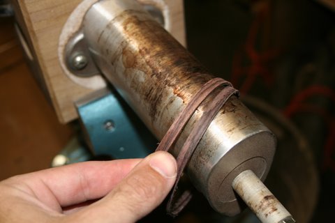

Then the binding is bent on a pipe to a 4" circle.

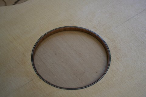

All is put into place and "clamped" with tape until the glue dries. Finished product.
Hope this helps. Paul
