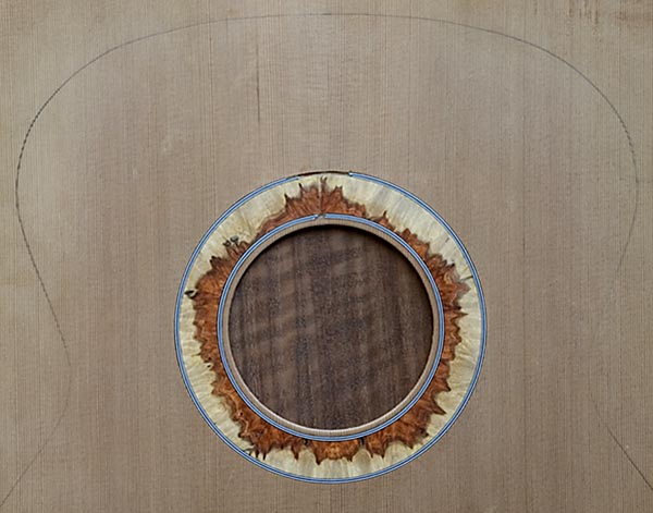

It’s been a busy summer as I’m sure any of you with grade school aged kids on summer vacation can relate to so I haven’t been on the forum much.  But I did get a chance to make some headway on no. 2 over the last couple of weeks.  It’s an SJ sized guitar for my oldest daughter.  I’m sure it will be a year or two before anything challenges her iPod for her daily attention so she’ll have some time to grow into it.

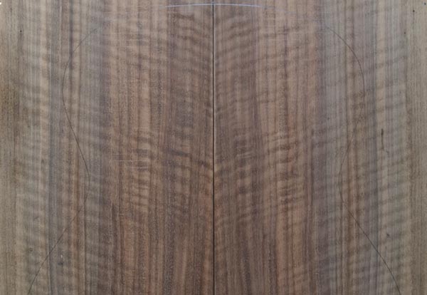

Claro Walnut B&S
Cedar top
Cocobolo end graft and bindings
Question - This is my first time working with a cedar top.  Assuming it’s reasonably stiff, is it common to thin the edges a bit at the lower bout like many do with stiff spruce tops?
Doug Mills

The way to treat cedar is how you would treat spruce, yes. Flex the top when thicknessing and check it's as flexible as you'd like. You'll find when you get it to the right point chances are it'll be thicker than a spruce top, as the wood's not quite as strong.
Shaving round the lower bout's also a great idea, I do it on every instrument.
Love that rosette by the way!

Very Nice!  I also like the rosette.

Ditto on the rosette... Looks like a solar eclipse. Gorgeous!

That looks great to me.  I see solar prominences in the rosette.  Really nice work.
PostPosted: Sun Sep 09, 2007 6:21 am
I have to say that is one of the most interesting rosettes ever. Congrats on that.
Your claro walnut is really fine too.

Outstanding rosette!

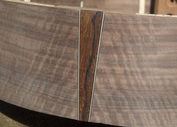

You have recieved excellent advice on the cedar top. Be careful and dont sand thru that rosette though!  Man I like that!!  Nice job on the end wedge too! very clean joint!

Good hearing from you again, Doug! Nice to have you back.
I love that rosette...details please

Nice rosette, what kind of wood is the rosette? That guitar is going to be a beeute.
