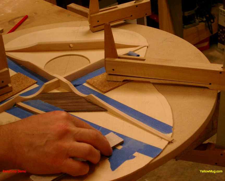

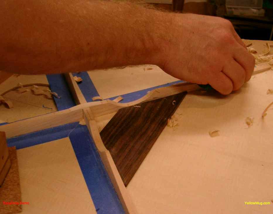

Im currently working on bracing for a 12 string. Top is Lutz spruce and around the bridge area its worked to 0.130". rest of top is about 0.125" thinning to 0.110" around perimeter of top.
Ive scalloped the long arms of the cross brace so theres peak one third of the way down the brace. The peak is about where the saddle will be.
Id like a critique of the scalloping on the cross brace. Am I in danger of having the top in front of the bridge hollow out or will I be ok?
Any thoughts welcome.

Heres the pic

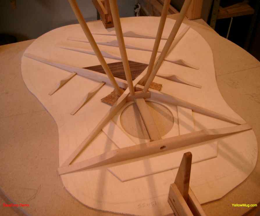

Better pic showing upper tone bar in place.
PostPosted: Mon Sep 03, 2007 2:15 pm
Okay, Since any thoughts are welcome.
Did the chisel get away from ya there?
I think it's a wee bit pared away there near the x and bridge plate.
I'd chisel them off and try again.
But it does really look nice, great job in the surgery.
Good luck, and yeah, It looks like it might implode or explode to me. I've been wrong before, so if you have lots of time to build prototypes, keep up the good work.
Now, I hope those thoughts were welcome.

What's the theory?
Looks like a recipe for collapse and disaster to me...even on a six string.
PostPosted: Mon Sep 03, 2007 2:23 pm
Since you asked....personally I thing iyts too scalloped between the X and the bridge. I would space out the scalloped area and move the peak about one inch outwards.....

Youve confirmed what Im already thinking. Off comes the cross brace then.

Well, God bless you if you have the time on your hands to do that, but if you're trying to get "from here to there" with guitar making, then you might consider going with the tried and true for a few before building the guitar equivalent of a balsa balcony railing in a movie set western bar for cowboys to crash through on camera!
Don't forget that scalloping bracing is a deliberate and usually incredibly successful attempt at weakening the braces in order to control the nodal response of the top at certain frequencies. This is one of those structure vs. tone issues.

Yikes Martin ! If you are to scallop at all , start well past the bridge . I've chosen to use tapered bracing for my 12 with the parabolic type shape. Here's a pic of mine
Hope this helps
Cheers Craig

Martin...I'm searching from memory here as to the key points others have stated when designing bracing for a 12 string. Here are some items I remember:
...5/16" X-bracing scallopped similarly to that of a 6 string...voice accordingly but err on the side of heavier bracing. Some have stated that their 12 string bracing departs little from 6 string.
...1/4" tone bars...some have added a 3rd tone bar (like Craig) but I've seen a lot with only 2
...Slightly thicker top...yours sounds like a good start depending on thickness.
Hopefully this will generate some comments from others who know more.
BTW...I commend you for speaking up on this before gluing that top to the sides...you must have had a sense that it might be a potential bomb.

Appreciate your opinion Lance .It's an Englemann top and fairly light . I have the box closed now and am getting a G# from the top ,without bridge . It seems quite responsive and ( was ) fairly happy with it.
The lowest tonebar is only 5 m.m. and the rest have had been carved away till they are quite thin .As this is my first 12 string , I had advice from a very experienced builder here in Australia ,who has built many successful 12's, He emphasized a large bridge patch and not to scallop.
Where do you think I should lighten up ?

Surgery is nearly complete...Ive gone for a tapered cross brace and three tone bars as on Craig's instrument.

Another thing I was advised was to locate the first tonebar up close to the bridge patch , and have it angled so that the end of it almost intersects the crossbrace at it's end.
I note Taylor and others do this also.
Cheers, Craig

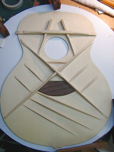

PostPosted: Sun Sep 09, 2007 7:54 pm
Posts: 1055
After some major surgery on the cross brace and a rethink of the bracing on the lower bout here's what I've finished up with.
