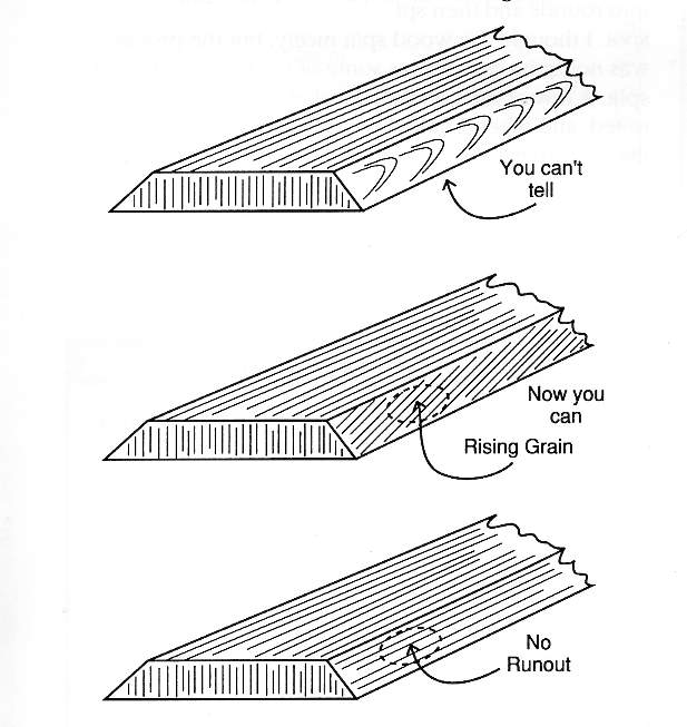

When resawing some old growth and hand split billets of Western Red
Cedar, I thought I would try the beveling method for detecting runout. I
never put much thought into the method but after a little thinking, I
realized that this method does NOT detect runout and should not be used
for verification. There is a small picture of the method below for those
who haven't heard about it.
The only thing this method does for quartersawn wood with distinct
annular growth lines is show the lengthwise movement of the grain. By
that, I mean if the grain lines are perfectly straight and stay parallel to the
bevel, you will see the lines run straight along the bevel. But if the grain
lines move to the right or left they will appear to move up or down on the
bevel face. Supposedly, this is how you detect runout. But the direction
and movement of the grain lines on the bevel face is entirely unrelated to
runout.
If you disagree, please test this yourself. It only takes a few minutes to
verify and if you stop and ponder it, I think it is fairly obvious. After all
the growth lines are like "sheets" of wood not "strands" of wood. This
means that regardless of how much runout is in the piece, a beveled edge
will show perfectly straight grain as long as the grain runs parallel to the
bevel.
The only methods I know to detect runout are
1) visually on bookmatched sets
2) via touch which doesn't seem to be very reliable
3) the best and only real method is to split a piece of the billet or set and
see how the grain breaks.
This just goes to show that the "tonewood lumberjack" is the really
important part - it is up to them to cut the wood so that any runout is
minimalized.
[IMG]../forum/useruploads/SimonF/2007-09-07_000402_Runout.jpg[/
IMG]
PostPosted: Thu Sep 06, 2007 3:05 pm
Posts: 1025
I don't know why the picture didn't load. Here it is again.

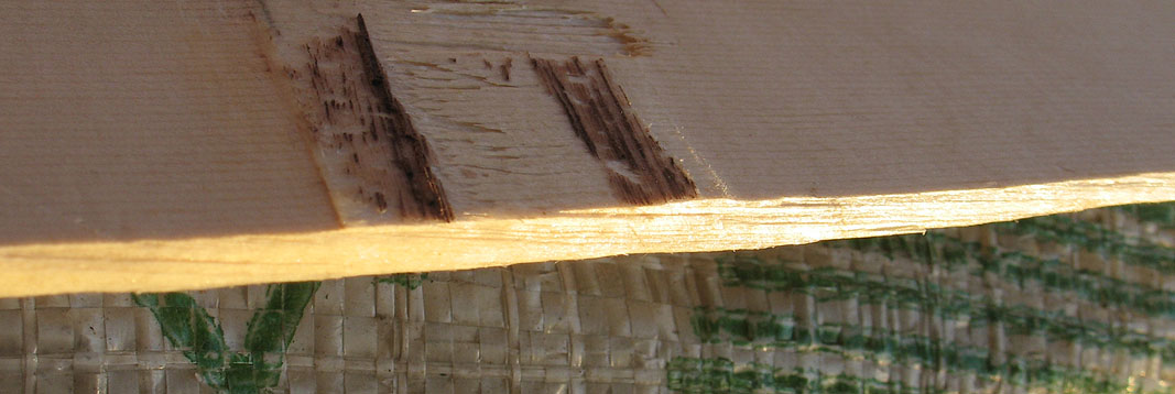

One last thing I wanted to mention. When I was messing around with this
method today, it initially makes a lot of sense. But when you think about
it more, it starts to break down and you realized that it really doesn't.
I remember seeing this photo of a top with extreme runout. If you took
this board and planed the edge, the runout would no longer be visible.
All you would see would be the growth lines running fairly straight down
the board. So an easy way to test this piece for runout would be to cut
off a 1" section at the edge (or however much you could spare) and try
and split the grain with a fine chisel. You would then easily see the
runout and it would once again look very similar to the picture.
So once again, the bevel method doesn't work. Just thought I would
mention this because I never thought to question it and have been relying
on it for the last year or so.
