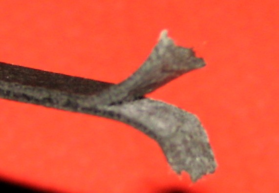

I have some guitars coming up where I want a nice, clean, solid black binding.  Unless there are some problems with fiber (color fading, layer separation maybe) it seems like a better use of resources.  Any thoughts?
I suppose plastic is an option but I'm somehow even more resistant to that.

Thanks for the info, all.  It's helpful to know that some folks have had some long history with it.  I've gotten in the habit of milling my own wood binding for years and have never had reason to consider or look into other materials.
I'm also curious if the stuff I got from Grizzly is the same as the stuff you are talking about.  It sure seems to be laminated from sheets as opposed homogenous.  See photo.
Rick, I'm little confused by your response.  You say...I just think that there's too much...well for the lack of another word "paranoia" about some materials, and yet with a little digging, the information is right there in front of your face.
It seems to be critical of asking an honest question in a forum designed to answer them.  This forum is right in front of my face and the place I chose to dig first.  Turned out once again to be a pretty efficient way of getting an answer.  For instance, it would have taken me a fair amount of digging just to find out that the trade name is vulcanized fiber.  Where better to start digging for guitar answers?
And I totally disagree with...It's great to be cautious, but the only way any of us find out about "new" materials is to try them.
One of the great things about just such a forum is the pooling of collective experience.  It makes it so we don't all have to make the same mistakes.

Also, as far as de-laminating...the stuff you showed was probably not vulcanized. Look for the good stuff!
