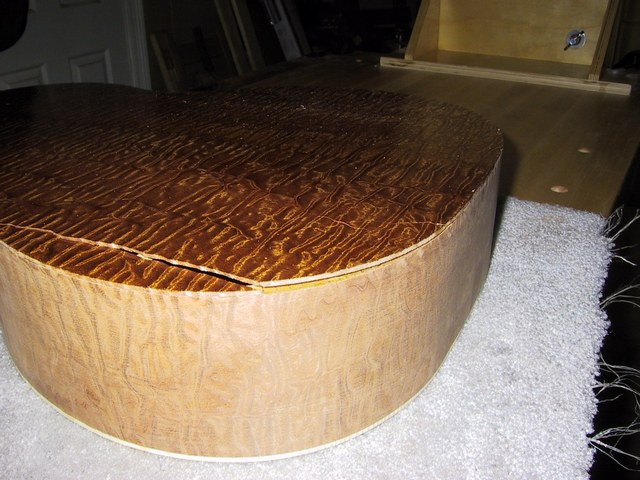

Hello everyone,
I just strung up my first build and setup my initial setup which was a
fantastic feeling. I was playing on the sofa finding it hard to believe that i
had managed to make something that sounds half decent when i noticed
a 2" hairline crack running along the grain of the side of the guitar. It's
between the lower bout and the end block and is shown by the yellow
mark on the (pre-crack) photo below.
This is the best close-up of the crack i could muster:
Do you thing the string tension has pulled a pre-existing weakness open?
Anyhow i'm not sure how to fix it - that where you lot come in - i hope!
Thanks in advance,
John.

Ahh, time to learn the gentle art of guitar repair.   I'd cross grain cleat it using rare earth magnets to clamp several cleats in place.   Are you keeping this one?

Rick,
Yes this guitar is for me. I learned so much making it - and made my
share of mistakes, at times feeling more like a repair man than a builder. I
have some R.E. magnets from when i cracked the back so it should not be
a problem to apply cleats. One question: would you try and work glue
into the crack or not - It's pretty tight at the moment?

Does anyone drill in stop holes? I think for the top it would be essential.

I'd try to jack up the area of the crack to open it a bit, then moisten it with very hot water and then rub in some hot hide glue. Quickly release the jack and you should see some squeeze out.
Prepare some cleats and very lightly glue the cleat tops to some RE magnets so they will just stay as you handle them. Then clean up, tape magnets onto the outside where you want cleats on the inside, apply some HHG to each cleat and pop them in place.   This may take several applications as you can't get the magnets too close to one another on the outside or inside or they will attract or repel one another.

In my case I used Fish Glue per David's recommendation. It works much like HHG but with a much longer open time. Sounds like Rick has recommended a tried and true method as well.
Good luck and keep us posted.
