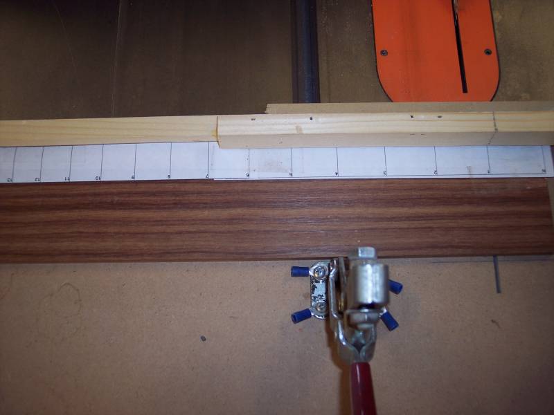

Here's mine... I just use tape to attach the scale. I'd make sure your think kerf blade works out to the right kerf size. I use Stewmac's, and it's worked out great so far, and the frets went in just right. I don't think there's a whole lot of room for error.
I use some high magnification reading glasses (the most powerful I could find at Walmart) to align the scale.

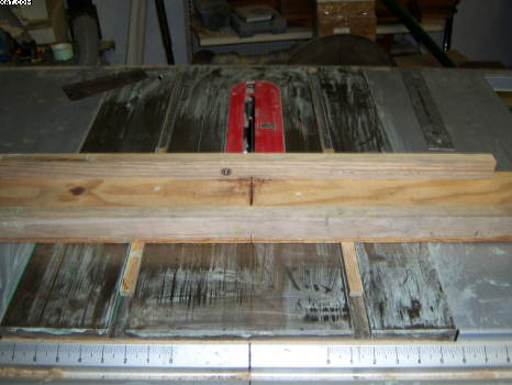

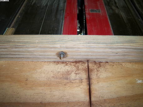

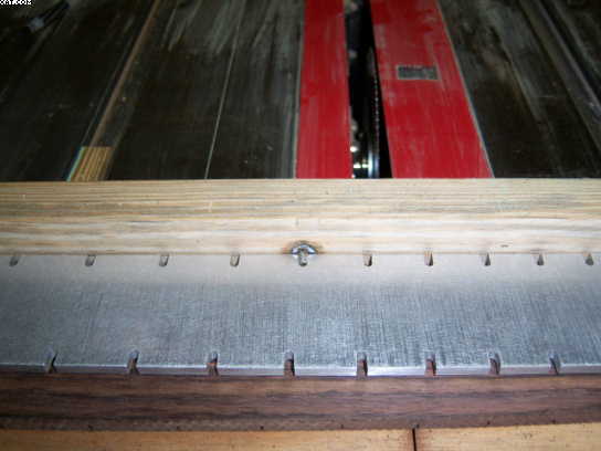

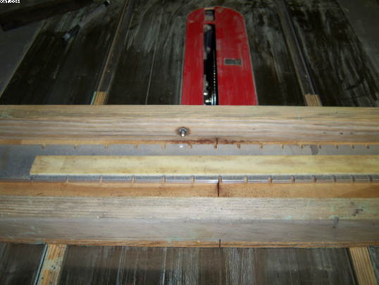

Here is my fret slot cutting jig. I just cut some slots today using a template mde by our newest sponsor, St Lutherie. My sled sits really tight in the slots on the bed of the table saw. So tight that it will not slide without some car wax applied to both the table saw and the bottom of the sled. The green stuff you see on the table saw is turtle wax.
Here are 4 shots of my sled. Hope you "get the picture"
i use double sided foam tape to hold the template to the fingerboard. It releases easily when one fingerboard is done and a new one can be stuck right in it's place.
Hope this helps.
Ken

PostPosted: Wed Sep 05, 2007 11:18 am
I forgot to mention....
the bolt you see sticking through the rail of the sled is an indexing stud for the template. I kept shaving this down with a file, one stroke at a time, until it just would fit into the slot in the template. VERY precisely. You dont want ANY side to side movement of the sled or your frets will be off.
Also, I got the blade from another one of our sponsors, Shane at High Mountain Tonewoods. It required some blade stabilizers, which I got from my local woodcraft store for $18.
Dont try to cut anything except a fret slot with one of these blades. They overheat quickly and will warp at a moment's notice. They cut fret slots like a champ though.
