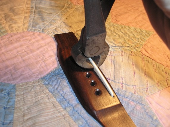

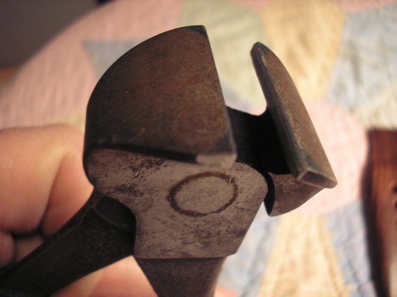

PostPosted: Sun Sep 02, 2007 12:39 am
PostPosted: Sun Sep 02, 2007 1:06 am
I made this to rock the saddle out . I just ground down the sharp edge . It works very well.
PostPosted: Sun Sep 02, 2007 1:45 am
Posts: 2060
I did the same thing to a set of end nippers as Dave posted above, though
with a mini set. And it's hard to tell from the photo, but I think my flat-
ground edge is a bit shallower than those. It is probably one of the top three
tools that I use on a daily basis. For pulling saddles and bridge pins it's what
I have automatically grabbed for the past 10 years, and would feel rather
lost without it.

david beat me to it. i was turned on to this adaptation of end cutters many years ago. iirc it was don teeter who recommended it.
