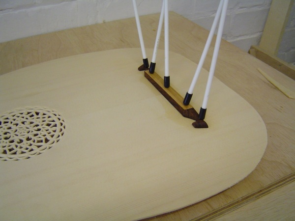

I haven't on a steel string though I have been toying with the idea, but I always glue the bridge on my lutes with the go-bars. Of course the top hasn't been glued to the shell!
