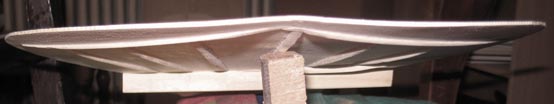

I had a top done, after of a lot of hard work bracing and voicing it I was so pleased with it that i decided not to put it on the topless box I had at hand, but rather to start another build from scratch.  So i started to carve a new neck, and in the mean while a heat wave struck.  It got so hot in here that I was sweating a lot while carving that neck, also drunk a lot of water. Never imagined to me that the humidity is probably rocketing. At the end of the day, again pleased with a very nice neck from the first attempt, I had a look at the top to check the 12fret thickness and make the neck rebate.   CURLED.  The face turned concave on each half.  I was ready to cry to be honest... As always, when things go smooth and nice in a row, they surely must go utterly wrong soon .
I moved it to another room that has a more pleasant air (at least it's not hot in there), and put it in a dish with a couple books on it.   Now it's time to pray...
Build log

Hi Alex,
I feel your pain. The woe’s of humidity can weigh you down!
The same thing happened to me, and I did just as you did, putting books on the top to attempt a
return to its original shape. I had to leave it weighted down for a week before I got any good
results. Still, the best I could get, was pretty much flat rather than a full desired 25' radius. I
think that can still work, because there is really nothing wrong with a flat top. However, You may
want to leave yours weighted down longer. Could work, you never know till you try.
Robert

Alex, I had the same experience with a back that I didn't put glue to the sides right away. I was going to do some experiementing with tap tuning. When next I checked the back it was a very peculiar shape and the cross braces were even bowed! We've had a lot of rain here in the midwest lately and I guess humidity was the culprit.
Good luck,
Max

If you return the top to the exact humidity it was when built it should be fine.
Good luck figuring it out.

Rick's right - given the value of the wood and instruments in a shop,
maintaining a reasonable humidity can seem cheap in relation to
damaged instruments.
I keep the main 700ish square foot working section of my shop at 50%
+/- about 5% year round. I use one main dehumidifier +1 backup, an air
conditioner, and a central humidifier for winter, all of it directly hooked to
the plumbing so aside from filter changes I don't have to worry about
filling and draining. It seems like a big initial investment, but it certainly
saves a lot of headaches over time.
At the very least, a dehumidifier or air conditioned room or closet is a
must have for summer humidity, and a humidified area for winters. For
the current problem at hand, put in in a good environment and hope for
the best. Oddly enough, I would have guessed it has dried since bracing
it. When the top swells from increased moisture content it would typically
cup the other way.

Hmmm.  The summer here is not exactly wet.
When i braced it, the outside humidity was 30 to 50% during day time and 50 to 70 during night.
Then the heat wave came.
Today, outside, it has been as low as 17%.  At night it won't go over 50.
I keep the  "shop"  ventilated with  the balcony door and window open maybe 23/24.  It gets very hot in here because of sun exposure.
So if it in fact cooked up and dried from the heat, maybe I should damp the concave outer face ?
Or maybe I could wait until tomorrow. Rain and storm is expected...

Right, what you really need to do before anything else is set up some sort
of a closet, box, cabinet, or whatever that can be controlled at a stable
50ish% humidity.
If the top comes back in that environment, great. If not, strip the braces
and rebuild it at a good moisture content. If it was indeed braced when it
was too humid then there's really not much you can do. If you over-
humidify it to bring it flat before gluing it on, it will only collapse and/or
crack as a completed guitar. If it stays curled after a few days at 50%
humidity, rebrace it and consider yourself lucky that you found the
problem before it showed up in a completed instrument.
Humidity control and moisture content of woods is absolutely
imperative
when building instruments. There is no way to build a
predictably reliable instrument unless this is considered and controlled at
every step of the building process.
Set up a stable storage environment first, then move on from there.
