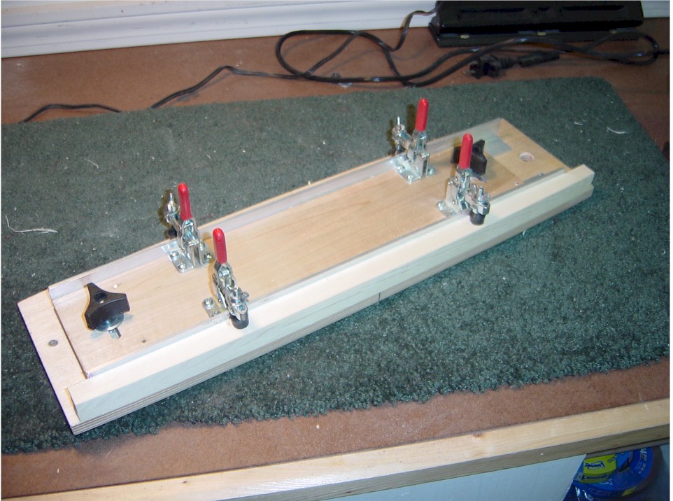

EDIT!
My simple brace radiusing jig was roughed out then sanded in my dishes 25' one side 15' the other. I use it with a table router. But I still finish off the braces by sanding in the dishes.

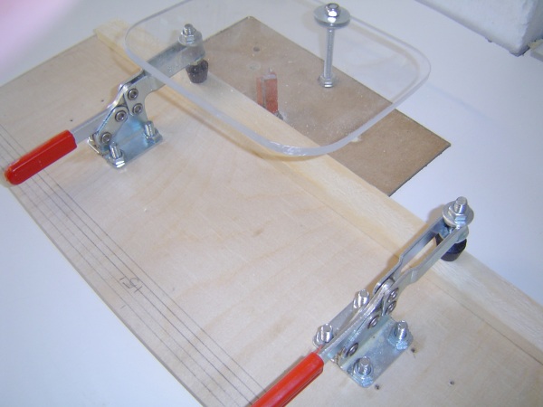

Posts: 147
Here is the jig I use for radiusing my braces.

Thanks everyone. I think I am going to make a jig similar to the ones posted
by Colin and Mark. I guess I will just make a template using my radius
dishes and transfer that to the jig, so I can rough cut it from there and sand
it to smoothness.
Colin, do you just unscrew and reverse the clamps when using the other
side?

PostPosted: Fri Aug 24, 2007 8:49 am
[QUOTE=EnFuego]
side?[/QUOTE]
Yes, I make up a batch of 25' blanks, undo the bolts turn it round and do a batch of 15'. I've been meaning to make another one for years so I don't have to, but somehow it's never seemed to be worth the time.
