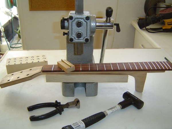

I use an arbor press and wood cauls with the Stew Mac inserts, I can get all of the board on the neck this way if I use an extension block for a couple over the heel. I fret with the neck off the guitar but with the fingerboard on the neck, my neck extension lets me do this. I like the arbor as it is solid and has no give in it. This one I bought at a local tool shop in the UK for less than half of the price of the Stew Mac one, though if you look you'll see that it is identical.
With care and checking as I go, no fret levelling is needed. At least for the last three guitars.

I just cut a slot in a piece of cherry and put the Stew Mac Insert into it, so not even any cost for the insert holder. It also allows me to easily turn it 90deg for some of the end frets.

Colin:
Could you elaborate, please, on how you get those frets over the heel. I have exactly what you have regarding an arbor, but I still had to tap those and ended up getting rather frustrated.
Thanks in advance for your valuable time. Pics are always greatly appreciated.
