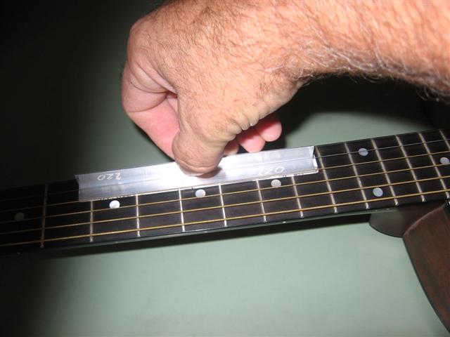

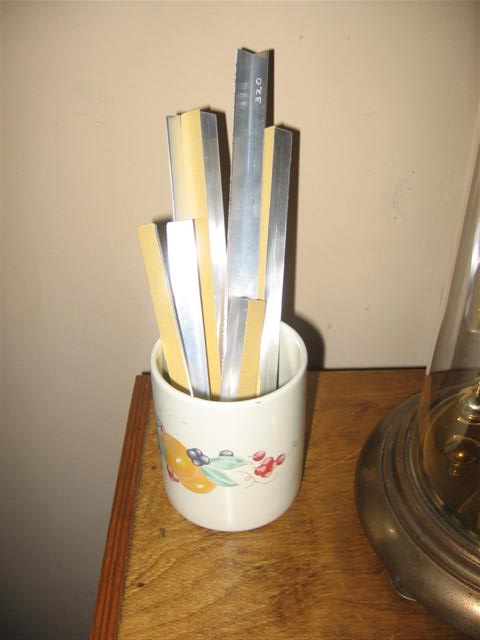

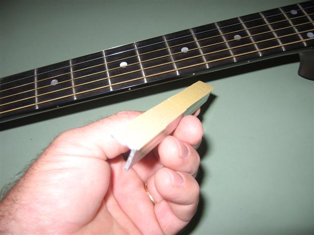

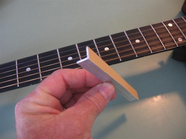

This is a coffee cup full of little aluminum fret levelers. It is such a simple tool, no one has put a picture up until now. I have one ten inch, one four inch, the rest are all 6 and 8 inches.

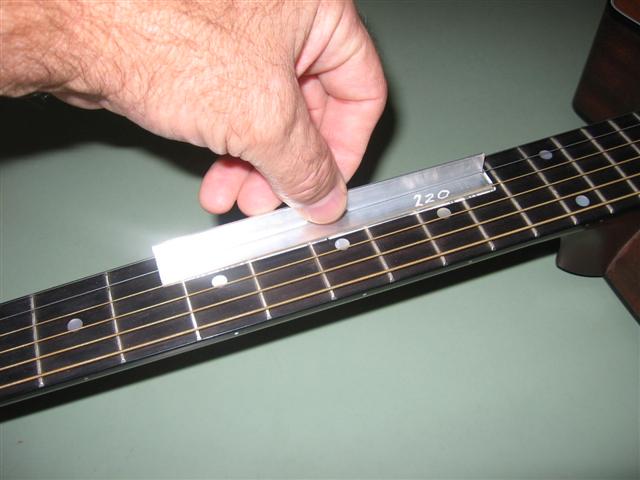

They slide under the string at tension to level the frets and progress through the grits to get 'em smooth. Evan and Rick had a couple threads going which talk about them. This is just a visual aid for slow learners like me.......
Just release the truss rod to flat then you begin your efforts to level sand the frets under full string tension. as Evan said: It's so fast it's scary. You may want to start out on an old junker before moving to your nice hand-builts.
Refer to the other two threads for details. I used some 6" Mirka sanding discs to get the grit I needed. Rick uses rolls to get the length needed.

I still don't get it. Why worry about the truss rod with such a short leveler?
PostPosted: Wed Aug 22, 2007 6:15 am
Posts: 4820
It makes sense that if you're trying to level, start with a level surface. It
takes a few seconds to adjust the rod, so why not?

Hesh, you've got it. Use a straight edge along the fretboard to make sure
it's level before fretting.
I'm not sure I understand the question about seeing a description of the
entire procedure using the levelers. Do you mean using the levelers
themselves, or the steps you posted?

Hesh, I simply point you to the comment Rick made in the other thread. Just do it.
I think the reason no one ever posted pics is that they are almost self-explanatory.
Once I made them, it was a real let down to actually use them. All the mystery was gone! I can now level anyfret anywhere anyhow!
Couple this with my old Stanley #5 body wrapped in sandpaper to level fretboards before fretting and geeze, necks, fretboards and leveling is a breeze.
Matter of fact this is somewhat of the feeling I get when all the planets align. Oh my.

I have another question, please:
On a new guitar, do you do this right after stringing it up or would it make sense to leave the guitar strung up to full tension for a couple of weeks to see if it has settled down?
PostPosted: Wed Aug 22, 2007 2:36 pm
Posts: 1398
Ron, if you can afford to have a guitar hang around for a couple of weeks, then yes, it makes sense to do this when the guitar has gotten used to being a guitar...a little bit. I'm generally in a place where it has to ship within a couple of days of getting strung up.

Hesh, one thing I'm pretty sure Rick said in one of the other threads is that, on a new guitar, he levels the frets before stringing it up (as the rest of us have already been doing). Then he strings it up and uses these "Turner fret levelers" to do a final leveling, if necessary. My understanding was that he sometimes finds it's not necessary to do it at all, i.e. that the frets check out level when the string tension is on and the truss rod is adjusted to re-straighten the neck.
