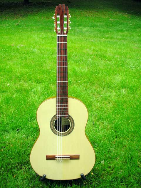

I finally completed Flamenco #1 (also Guitar #1) "Alexandria" it is a Manuel Reyes built from Tom Blackshears plans. The top is German Spruce, the back, sides fingerboard and head plate are all cocobolo, the bindings are curly koa, with a spanish cedar neck. The finish is French Polished.
I definitely learned a lot from #1. I went through 3 neck blanks, and 4 bridge blanks before I got it right. I also finished it and sanded it back down twice, before I got a finish that I could live with.
The next one is going to be German Spruce and Cobo as well, but of a Miguel Rodriguez Jr. Design.
Thanks for looking.

Nice work Darin Very good for a first effort and definitely something that I'm sure you are very proud of. There is nothing like stringing it up and sitting to play and thinking... "gosh, I MADE this and it sounds GOOD."
I like the Cocobolo, nice figure and the backplate on the headstock is a nice touch also. Keep up the good work.
Have you started #2 yet? Why not??

It did not sound very good at first I got a lot of buzz on the first and second fret. I leveled the frets, re-crowned them and still had a little buzz so I raised the saddle 2mm and now she really sings. This is my first Flamenco, the sound is very bright.

[QUOTE=ToddStock] Congrats - looks great! How much fun was gluing coco? I'm enjoying all the extra prep immensely![/QUOTE]
I have heard a lot of horror stories on gluing coco. I almost decided against using it, but I love the look. Early on I made a couple of test joints using Titebond, and the wood would fail before the joint. Aside from gumming up sandpaper, I did not have any problems at all. I would not hesitate to use it again.
PostPosted: Mon Aug 20, 2007 10:36 am
Joined: Thu Jan 04, 2007 12:18 pm
Posts: 20
[QUOTE=azimmer1] Looks beautiful.
How about a close up of your tie bar? It looks very nice. What did you make it out of?[/QUOTE]
I bought it from LMI, It is supposed to match the rosette. Although the rosette is a little darker.
