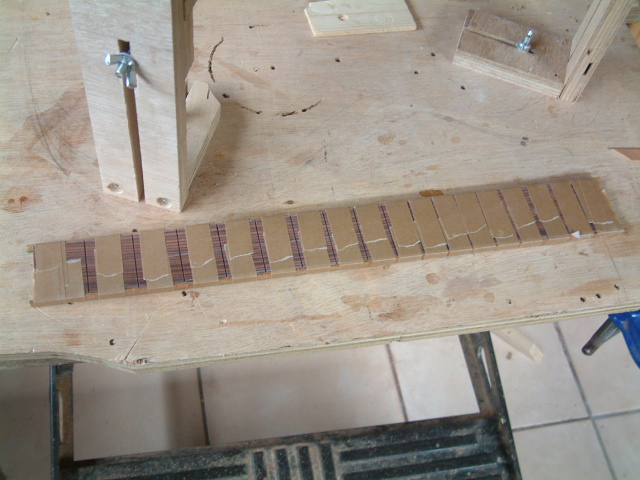

I do your first option. I glue the purfling to the binding using Titebond II - I use this for bindings that I put in the Fox Bender and they don't delaminate in there. I glue the binding to the fingerboard next - I have used Titebond in the past but might use fish glue in the future, holding the binding to the fingerboard with brown binding tape making sure that the binding is pushed down hard on a flat surface to get the bottom of the purfling flush, and checking along as I glue. It ususally comes out flush. If I am binding with the same wood as the finger board, I sometimes don't bind the soundhole end - I just cut a rebate in the bottom of the fingerboard here to fit in the end purfling and mitre it it with the side purfling, then polish up the end of the fingerboard.
Here's a pic of my binding method:

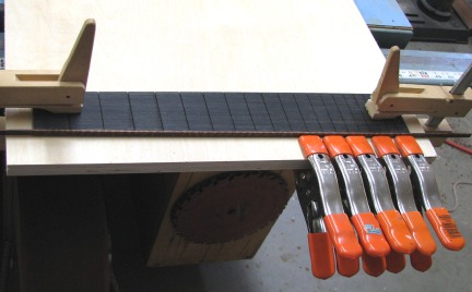

I glue the purfling to the binding (usually tape and titebond) and glue it to the board with CA as follows. I clamp the board to a peice of 3/4" mdf, about 1" from the edge.  (Put packaging tape on the mdf to prevent gluing the whole thing to the mdf!!!) I cut miters on the ends, position the binding, and put spring clamps on the mdf tilting them so that the ends of the spring clamps push the binding tight to the board. With a little care, you can get the binidng sucked up tight all the way and keep it flush on the bottom and wick in the CA. That make sense or would a picture help?

Like this but with clamps all the way...
If you tilt the clamps down a bit while clamping, they will push the purfling up tight.
