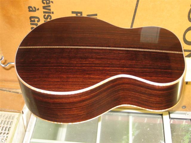

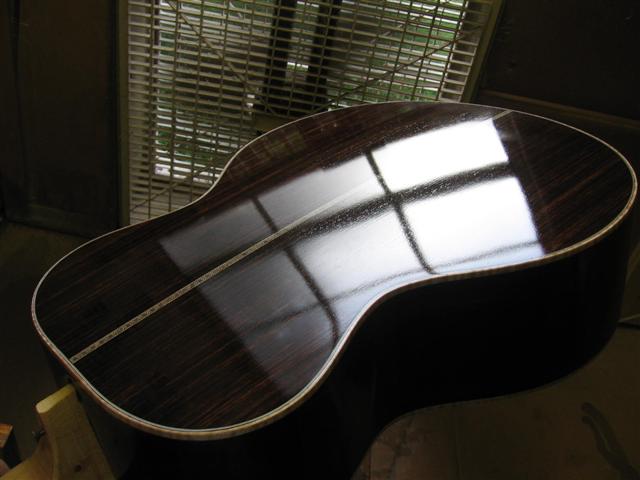

This is an SJ for my son. He graduates college tomorrow. Warren help me build the side bender for this guitar. He's checked the shop regularly to see it still on the shelf. Lately he's been too busy to look.
It won't be completely ready by tomorrow, but it won't be long now. Sorry for the pic quality. I'll take some nice ones later. Luthier's like this sort of thing. What's in your booth?
This is premium Indian Rosewood from LMI, maple bindings a gift from Bob Steidl. A cedar top from Ed Dicks. The bracing is Adirondack with a black walnut bridge plate. This guitar will get a set of K and K's triple bridgeplate pickups.
I decided to try epoxy fill again. It worked very well, but not perfect. I should have done at least one more coat. I did an alcohol wipe, to level the surface while still workable. I believe that step removed epoxy from many pores in the rosewood. But I'll sure try again, because it was a marked improvement over other past attempts to pore fill.

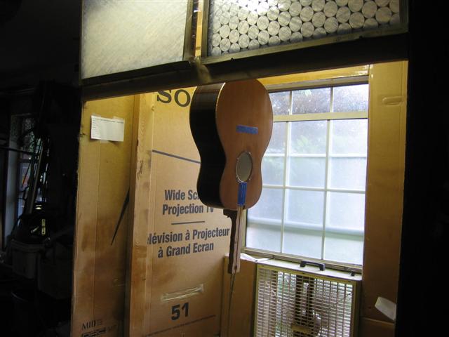

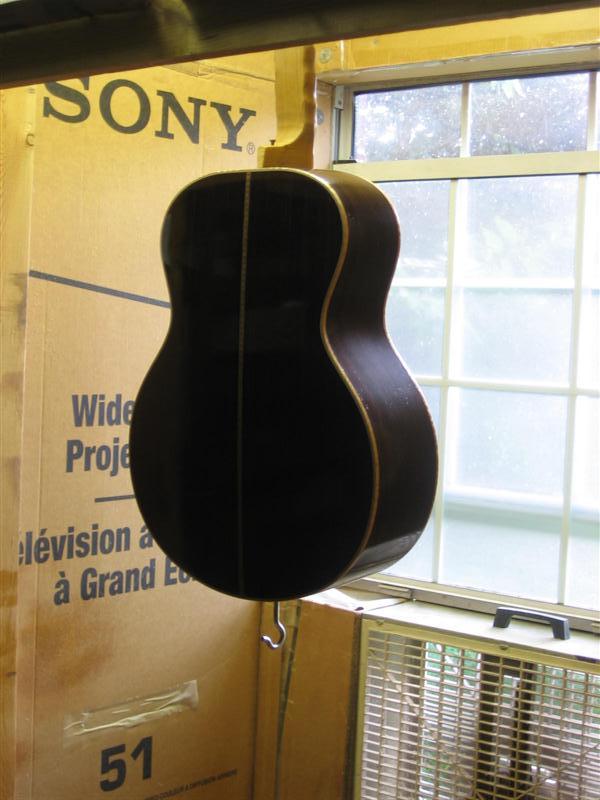

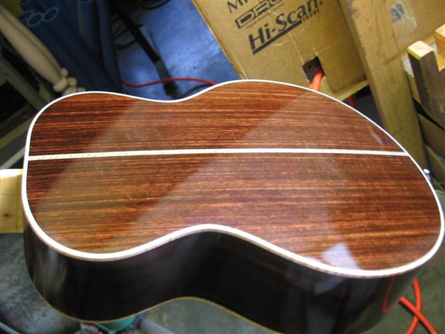

IF you look closely folks, the explosion proof fan is indeed in picture number three.
See the orange air hose on the lower right? The green thing on the lower left is an explosion proof fan and part of one aluminum blade is showing too.
Anyone remember TG&Y? It's a defunct five and dime store. The fan in the window is twenty-five years old it's a TG&Y brand with three speeds. I set it on high. The booth is a Sony big screen TV box held in place with two by four spruce framing. Works, that's all I can say.

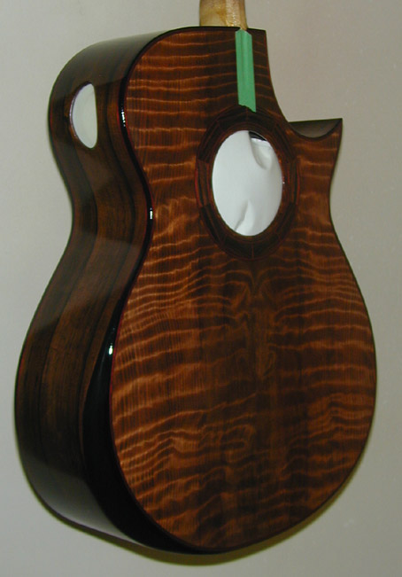

Just this one .... trying to get it to cure stage before next weeks time off ....
I think you can guess the woods ....

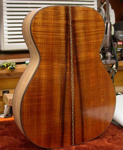

Not in a booth, since I don't have one, but here's a 000 I've been working on forever. Just has first Z-poxy fill coat, will get FP.
