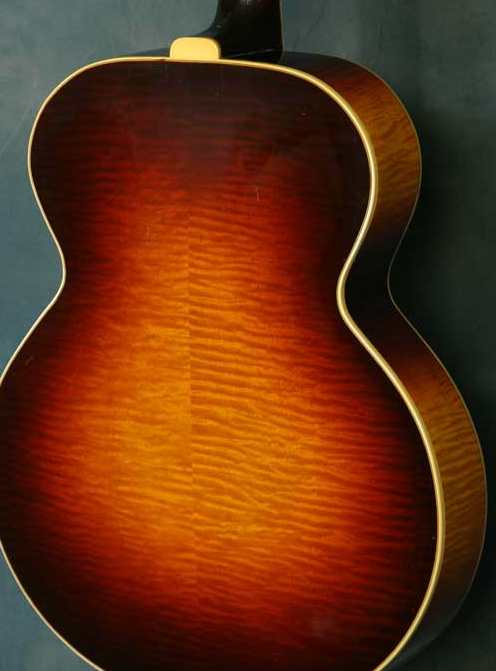

I guess I shouldn't have said "scrap it", but rather sunburst the burst the
back and sides. Shading is a beautiful thing, and is a wonderful age old tool
of hiding defects. If you don't want to burst this one then set it aside for a
future project.
PostPosted: Sat Aug 11, 2007 4:54 am
Posts: 2060
PostPosted: Sat Aug 11, 2007 5:18 am

Thanks, I actually did that burst in one of my previous lives when I was
working back in Kalamazoo.
That was a shot of a 40's Gibson L-5, not mine.
