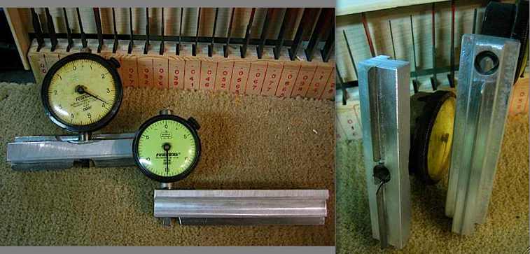

So here are the gauges. I made two styles. The one on the left will measure
the same thing you would view by eye - clearance above the first fret in
reference to the plane from the nut slot to the second fret. The one on the
right will reference from the plane of the frets and read the height of the slot
above or below that plane.
Of course the tools have to be leveled and zeroed out on a surface plate.
The first one (on left) will give a further negative reading for a high nut and
positive for a low one. The second (on right) will read positive for high and
negative for low, and is also twice as sensitive. I used the less sensitive of
the indicators on this one.

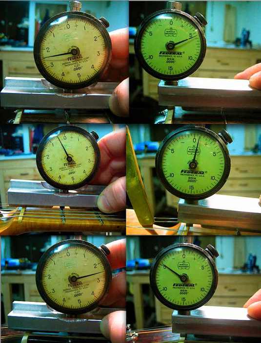

Here is a collage of each reading the same slot. High on the top row, good
(for the particular instrument measured anyway) in the middle, and low at
the bottom row.
With twice the sensitivity and a more meaningful measurement it would
seem that gauge #2 (right) would be more useful. Unfortunately it seems a
little too unpredictable in it's current state. The tip needs to be thin enough
to fit in a .010" slot, and the slightest twist of the tip can throw off the
readings tremendously. I also would have to increase the spring pressure in
the dial a bit to ensure it seats well in any given slot. The first one can be set
much more consistently in place.
PostPosted: Sat Aug 04, 2007 4:46 pm
Posts: 2060
Like I said, I don't often use them myself, but they can be useful. For many
people learning to work on instruments, nut height can be a big stumbling
block in setups. I emailed the to Dan at StewMac a few months ago, and it
sounded like Don Macrostie was already working on a very similar tool.
Hopefully they will be offering something like this in the not too distant
future. I'm sure many folks would find it useful.
PostPosted: Sun Aug 05, 2007 12:35 am
David, nice tool. But as you said above most of us can eyeball the height needed. I use a pencil that has been sanded flat on one side. I put the nut blank in the slot level the pencil on the first two frets and run my mark. It's always a little too tall using this method so I don't have to worry about "blowing the nut". once strung up I lower the string height to the players preference...now that's where a tool like yours that was notched (and perhaps worked perpendicular to the strings) so you could do individual strings would come in handy. I have had players want the first string as low as .007 off the first fret. With action that low it's easy to ruin the nut by accidentaly filing one of the other strings too low referencing off of that first string. With the changing diameter and tension of the strings the points where a string will start to buzz is difficult to acess. I guess after a while you sort of sense it. I think your tool is great . I guess using your tool you could collect the data and use it on future nuts with the same results...very ingenious!
PostPosted: Sun Aug 05, 2007 6:18 am
[quote]Unfortunately it seems a
little too unpredictable in it's current state. [/quote]
   Great approach!
   David, You could test over the top of the string, subtracting the diameter, that would give more area for contact wouldn't it?
