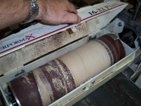

I have the Performax 16/32 sander and ever since I changed the paper on the first roll of paper that I wore out I have had some problems. I figured out that I was winding the paper backwards when I started tearing up paper left and right, but now I seem to have problems with burning the wood and also the paper loading up (see pictures)
This is 120 grit performax paper and it doesnt seem to last long at all. I loads up like crazy and burns the wood. What paper do you use and where to get it? Am I doing something wrong?

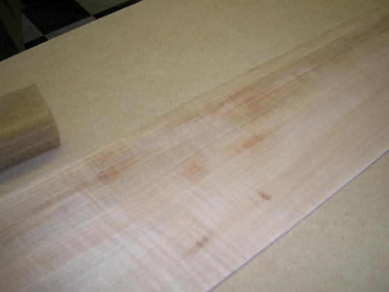

I have one of the rubber erasers from Woodcraft (you can see it in the bottom pic) but it doesnt seem to help.

You need much more vacuum! The dust is going around and being compressed back between the paper and the wood causing load-up and a tremendous amount of friction heat. The cleaner sticks help a little, but once you have burnt resin stripes, games over. Then you need to buy Wurth pitch and resin remover. Put some in a coffee can and let your belt soak for awhile, take out and rinse and you will believe you have a brand new belt! I use it for my hand-held belt sander, my 16/32 and my 43" wide belt. Here's a link. Go to page 10.

The better your dust collection is, the less dust and resin build up you'll get...I almost can't stress this highly enough.   A lot of that is the dust sticking to the drum and then getting mashed into the crevices between the grit as the drum comes around again.
Read Sando Nagyszylanczy's book on small shop dust collection and design a "stripper"...kind of an air knife to blow the dust off the drum and into your dust collection hood.

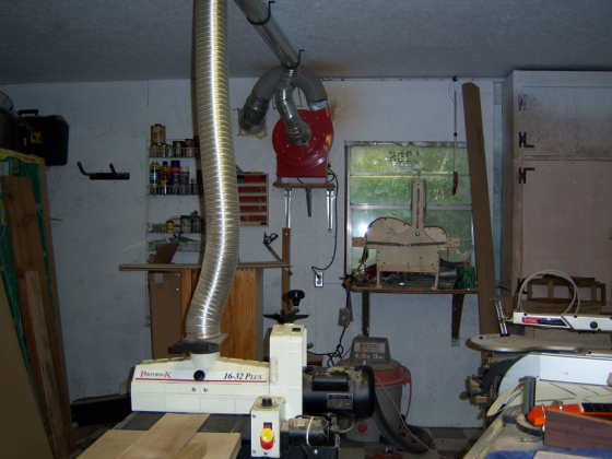

I really dont think it is a vaccum problem. My house vac system will literally suck an allen wrench off of the worktable. I do, however, believe it is a problem with the paper. I have been trying to take small passes as Hesh describes (1/8 turn) and it still happens. I dont know if the wood could be some of it, but this is some curly soft maple that I am currently working with.

Maple likes to burn. Going with a faster feed rate and lighter cuts will prevent heat buildup at the point of contact. The belts (as well as things like router bits) depend on fresh cool material to work in order to cool. Slow feed rates allow the heat to build up and once that happens you hit a kind of tipping point where the burnt sanding dust packs in on the paper and it all gets geometrically worse.

its a 650 cfm blower system and it vents to the outside (no collection or back pressure). I think I'll switch to the 80 grit paper.

I just realized that the shop vac on the floor might be misleading... i rarely use it... look above mounted to the wall and you will see the blower system I use. It is a 4" system and has a 6" exhaust that goes through the wall and into the chicken yard.
I also looked inside the exhaust port on the preformax.. there is not any kind of x brace or anything that would impede the flow of air except for the blast gate. I checked that for obstructions too...nothing there.

Ken, I find that Maple is one of the easiest woods to burn. Soft Maple easier than Hard in my experience. It won't usually pitch the belt like, say, cocobolo will but it will cake it much like your pics show. Maple does have a sticky quality to it (think maple syrup) and so it is pretty easy for the dust to cake.
As said before, increase you grit size and back off on the cut. If 1/8 turn is normal, try it at 1/16 turn. And run the feed wide open. It will be slower sanding but the belts will last longer so you won't have to take a break and change them.
