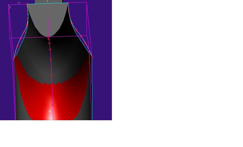

I've been playing with necks some in VX. Here's a couple of screen shots of where I'm at now with it.
Getting the surfaces to follow the curves and be tangent everywhere has been somewhat of a challenge.
Nelson and Rick, I have been planning on cutting the neck on it's side as Nelson is suggesting. I'll locate off of the truss rod slot and a locating hole on the neck blank using vacuum clamping. After the first side is complete flip the neck and mirror the program. This will allow me to get the shape I desire in the heel area. Now, if I can only get the surfaces just the way I want them.
A lolly pop cutter would of course work but it seems to me it'd have to be pretty long, maybe not as bad as I think. Are those available with out going to custom cutter?
It maybe easier as Parser shows in his tutorial and just get the major surface and touch it up later.
Then again it really doesn't take all that long to hand shape a neck does it.
Any thoughts are welcome.

Interesting discussion, guys. Jim, looks like you're nearly there on the solid model.

I'm not familiar with VX, but in SolidWorks, Rhino, and all the other packages I've used getting tangent/curvature continuous surfaces is dependant on setting up tangent/curvature continuous guide curves.
That model that you have in your screenshots is very similar to the level that I complete mine to with Rhino.
Looks great!!
