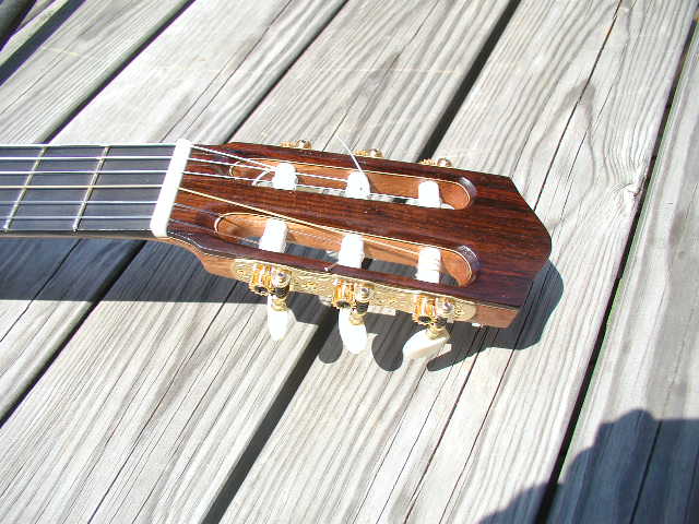

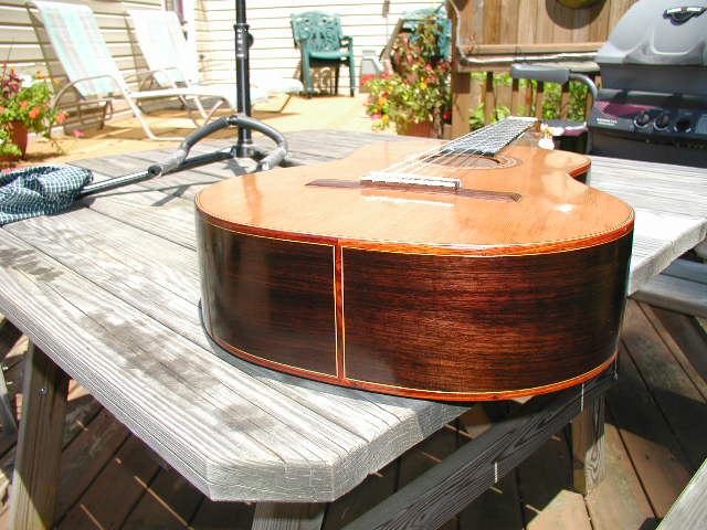

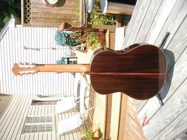

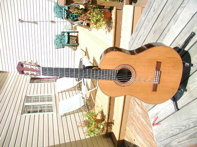

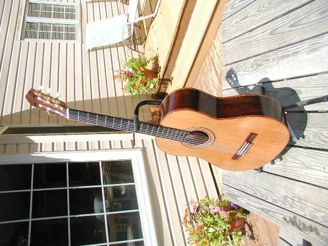

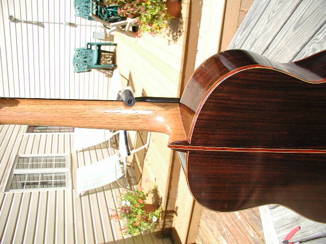

Hi everyone. Here is my classical number 2, just cleaned up and with it's final set of strings today. Like the one I posted back in January (#1), this is based on the GAL Blackshear/Rodriguez drawing. I'm pretty happy with the sound of this one, which came out well balanced like #1. I must have been more comfortable shaving things down - this one is a lot louder. I also think, though, that I can tell the difference between the immediacy of the notes on the first spruce top over this cedar top, and I think I like the spruce better in that regard. This judgement could be based on a lot of faulty memory, though, since I haven't seen #1 since February.
The owner bought the unserviced LMI kit for this one, so the parts are all from there aside from the WRC top which was too narrow for the immense Rodriguez body. I substituted one I had earlier from Kevin Hall. B&S, bridge, and headstock overlay are EIR. Backstrip and bindings are cocobola with b&w purfling lines. Backstrip extends over heel. Neck is Spanish Cedar.
I have to say that my French Polishing improved a lot on this one over the last. That one was embarrassing, this one is only 1/2 bad and is showing signs of getting there.

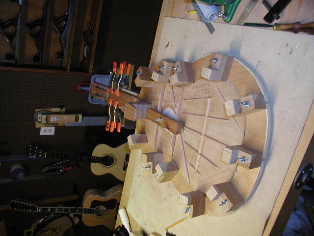

Here's a shot of the bracing pattern on this one, for those who are interested and don't know it by heart. Clamped to the Courtnall solera.
Jim Kirby
