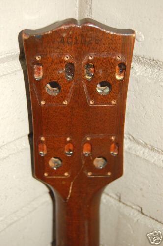

What would you guys recommend as the best way to repair this cracked headstock? The crack is only partially through and it has no affect on the trussrod function. It's from a 1965 Gibson EB-2 that was destined for the garbage. Other than the crack it is in very good condition. I'm thinking it might be possible to resurrect this old bass. Any repair gurus out there?
Thanks!

It looks like a straight glue and clamp job from here. How fresh and intact
the surfaces are would help me decide the glue (fish glue if fresh and clean,
perhaps epoxy if more heavily weathered or missing wood). No need for any
spline/overlay system judging from the photo.

Seeing the photo, I agree with David. I was thinking major Gibsonitis, not minor.   You could inject a bit of very hot water, let the water drain out well, and then wick in fish or hide glue. You'll be amazed at how far in the glue gets when the wood is hot and damp. Clamp it up overnight, clean it up and then you could do a bit of finish touchup. It'll wind up practically invisible and quite strong. Worst case you then can do an overlay if need be. Do the least amount possible that actually gets the job done.
Trash can, eh?   That's almost a collectible bass at this point.

I've never heard of that before but I'll definitely give it a try. It's a very clean crack that still fits together very nice. So fish glue is the recommended glue? I've never used it but will go pick some up for this job.
Thanks for the info fellas!

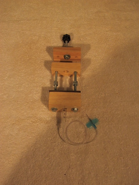

FG was a joy to use on my 1st repair of a crack. Just make sure you keep it clamped for 24 hrs.
It's good stuff and thanks to David Collins, I learned a grreat deal about cracks and acquired some FG in the meantime. I didn't know about Rick's hot water trick, but I made a pump setup that included a fine gauge butterfly needle to get the glue into tight areas.
See below:

is wonderful. I keep my syringe filled all the time. The butterfly needle in
the pic is mainly for hard to reach brace reglues. For a crack like that I
would either use a straight needle, or just work it in by hand.
[IMG]../forum/useruploads/DavidCollins/2007-07-31_144454_2.jpg[/
IMG]

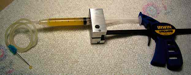

I've never tried wicking with fish glue because it has such a long working
time that you have ample time to work it in to deep cracks. My pic didn't
work above, but here's my glue injector.
With use of a flexible arm and an alligator clip it's great for interior repairs
like loose braces. For a repair like your headstock it's not really necessary.

By the way, I have repaired many a cracked headstock with cracks similar to that shown in the pic above. I always use HHG. Never had one come back.
