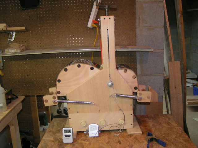

Has anyone got plans for the Fox Style light bulb side bending jig. I love to get blankets, but I think I'd like to try this first and save up for the blankets. I tried to search the archives, but didn't have much luck.

Peter I am with Hesh here. I bent using light bulbs for a year or so. I really recommend investing a blanket I really is the way to go. Bulbs have hot spots That make it on occasion frustrating. If You do decide to use bulbs rig your system on 3 600W dimmers Or at least 2 600w dimmers. The waist and upper bouts are so close to the bulbs it is easy to scorch and the lower bout seems to take for ever to heat up. So you want to be able to control the heat independently. I also suggest that you use 3 200W (clear) bulbs. 150W will work but 200W work better.
But the truth is It will cost about $60 for 3 ceramic fixtures, 2 600W dimmers, 3 clear 200W bulbs and a blanket and a variable wattage controller will cost you $120 there about from John at Blues Creek Guitars. So you really don't save that much.

I have no doubt that a blanket is better, but I'm a bit surprised at some of the comments. I've used bulbs for the past five years and I don't think I've ever even cracked a side and certainly never ruined one. If there were anything I'd be afraid of ruining with my current setup I'd be even more afraid to use it on a guitar.
I just use 3 200w bulbs. Never had any problem with there being too little or uneven heat, etc...
I don't think you'll have any issues using bulbs.

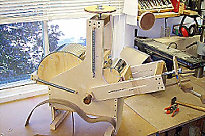

This guy explaion how he did his.
It is in German, but the pictures are English
Was helpfull to me.
Fox Bender built

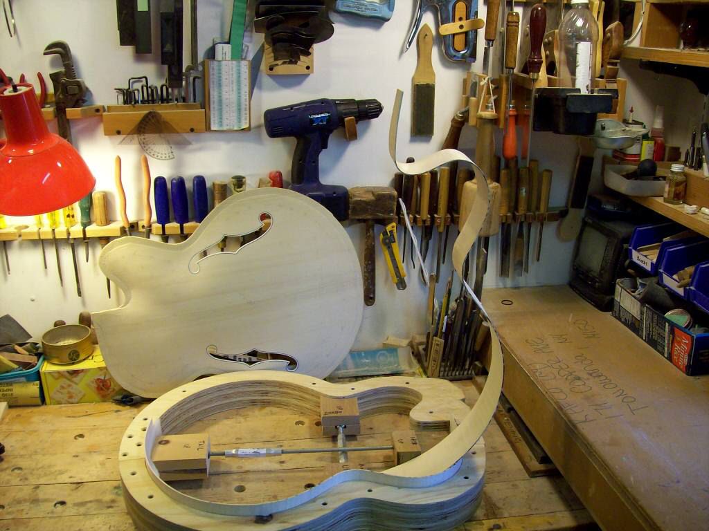

Further to my post above, here's a side I took out of the bender this morning. It's a new design for me & I was a bit worried because of the tight cutaway (1" R) and horn (about 1 1/4"). It came out great- no scorching (even with 55 min. start to finish time) cracks or blemishes.
