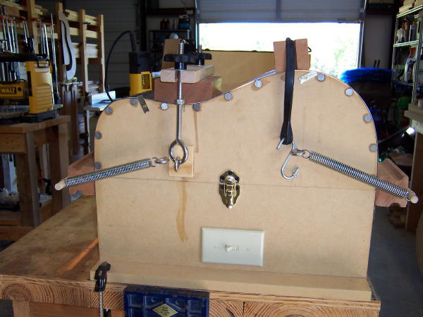

Here's a picture of Mike's side bender off his web site.
And here's a picture of the bender I made based on Mike's web site instructions.
And here's a link that I posted back in November 06 on my version of Mike Doolin's side bender, Rod True's, Doolin style side bender. There is a link about 3/4 of the way down the the thread to Mikes web site and his instructions, but this will be faster

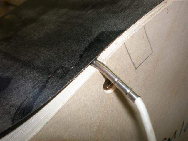

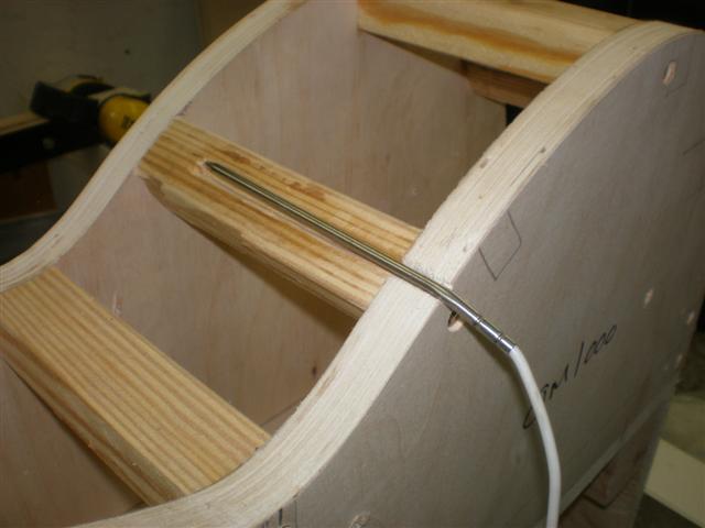

Also, I forgot to ask about the temp probe.  What, where and how much and how do you use it?  Looks like the probe cord is wrapped around the front with the probe ready to use.

Steve, the beauty of this design is that you reference the side off the tail end.
If you look at this picture, you see a pencil line on the bending form. That is the centerline of the body. I just lower the end of the side to that mark, clamp it in tight and start the bend.
I made the base of the bender to be able to take the smallest body length I currently build (which is 19 1/2"). The bending form only rests on top of the base (locater pins hold it in place) so I can just take off one form and put on another of a different size.
As for cutaways, I don't personally like Venetian cutaways and only make florentine cutaways so I don't have to worry about incorporating that into the bend.
As for the temperature prob and thermometer. I got it at Wal Mart, cost was about $15, look in the home appliance section near the toasters etc. I got this one for the very reason you see in the picture, I liked the idea of leaving the thermometer on the base and just putting the prob into the bending form. I have cut a small groove in one of the support bars just at the surface of the form and the prob goes in there once I start bending. Before that, it goes into the "sandwich" on top of the wood so I know when I can load the bender and start to bend.
One other thing that is different about my bender vs Mike's is that I don't use solid bending forms. My forms only have the sides and have support bars that run between the sides, see the screws, those hold the support bars to the sides.
I wonder if having an open bending form helps to dissipate the heat a little quicker vs a solid bending form. Seems to me that it would, and I wonder if this helps with the bending cycle at all. Anyone have any thoughts on this?

I can see putting the probe between the bands, heater strip and wood before beginning the bend.  Do the grooves for the probe in the support bars get the probe underneath the stack in different places?

They say a picture says 1000 words so I'll include another picture for you Steve
I only have one groove in one of the support bars for getting the probe under the "sandwich" or stack as you've called it. This is really to make sure that I don't over heat the wood while bending.
Here is a mock-up for you

No offense Ron but your bender is not the same as the Doolin Bender. The Doolin bender uses the springs to hold the slats really really tight so the wood is supported on both sides through the entire bend. With the Fox style the wood is only supported on the inside of the waist because of the waist clamping caul design, and your style of bender doesn't support the wood under the waist at all (from the look of it anyway). And both the Fox and your bender require you to support the wood when bending the upper and lower bouts or at least the hold downs give some support but not the same as the tightly stretched spring steel slats like the Doolin bender.
I'm not saying that the Doolin bender is the best bender out there, but for me, it's fool proof enough that I just had to make one. After breaking 2 sets of Imbuia and one set of flame maple on my previous bender (similar to yours) I had to try something different.
