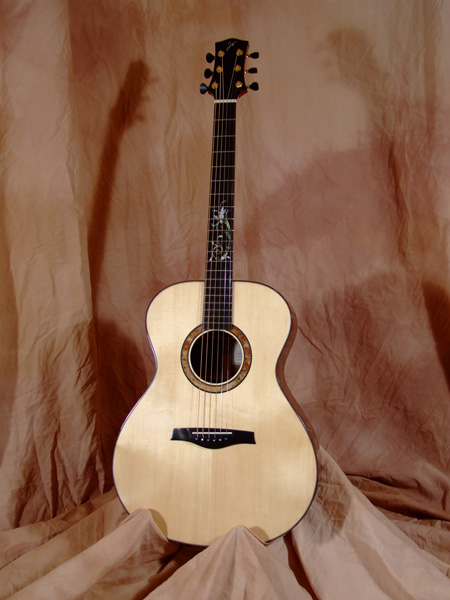

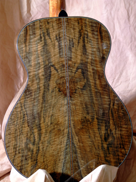

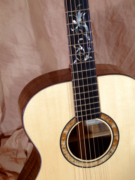

I Got this one finished up last week but just got some pics of it. This is one of my Healdsburg guitars. The background colors came out kind of pinkish in the phots but the wood colors look right
Details:
B/S - Bastonge Walnut
Rosette - spalted maple (first one I've done)
Binding - Claro Walnut
Bridge/finger board - ebony
top - Adirondack Spruce
Thanks for looking.

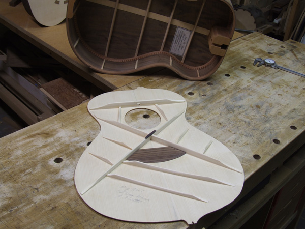

WOW! Was that Bastogne from Steve @ Colonial? I ahve a set and also an Adi top from him. I was really curious about the sound of the combination--how does it sound and what type of braing did you use? If you don't mind revealing that.

[QUOTE=af_one] --how does it sound and what type of braing did you use? If you don't mind revealing that.
Scott[/QUOTE]
Scott, the sound has really opened up over the last week like most new instruments and I really like the sound of it. It's very well balanced and clear.
Here's a picture of the bracing.

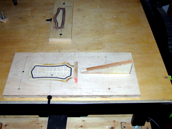

How did you do that peghead back?

Yes,How did you do your peghead back?

In response to "how did you do it?"
Well I have a pretty cheesy cnc router, it's ok, but I had to rebuild a large chunk of it to get to work, but it does work now.
I made a fixture like so..
The neck locates in the truss rod slot and the peghead against the base. I cut the headstock outer profile and the pocket for the inlay in this fixture.
I'm pretty sure this could be adapted to hand routers however with a little modification to the fixture.
This could be accomplished by pinning guide templates to it for the router to follow.
The key to getting it come out well was to install the purfling lines first, then the inlay piece.
I cut the inlay just a touch big and used a scraper to fit it into the purf lined pocket.
Hope this helps with some ideas for someone.
