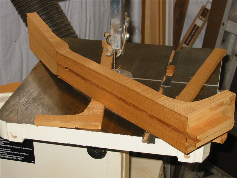

first I get my blank roughed out on the bandsaw.

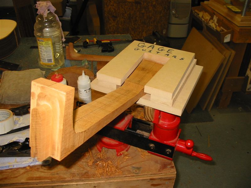

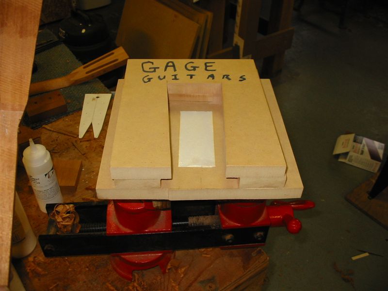

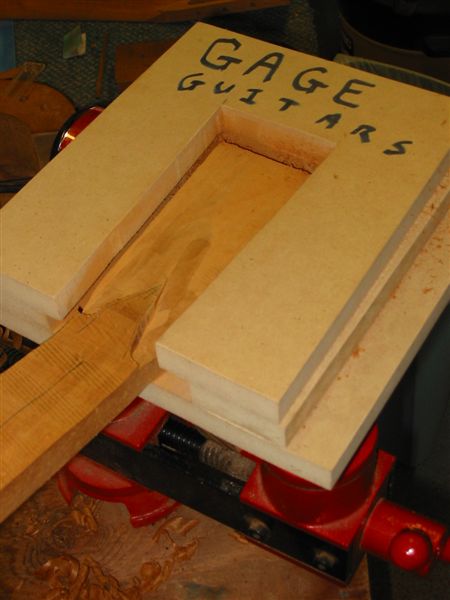

in this shot you can see the simple jig that i use to level the back of the headstock, and to rough out the diamond. if you look close you can see the lines i have drawn on the back of the headstock.
heres a closer look at the jig and my diamond Volute template.
The neck is held down by using double stick tape.

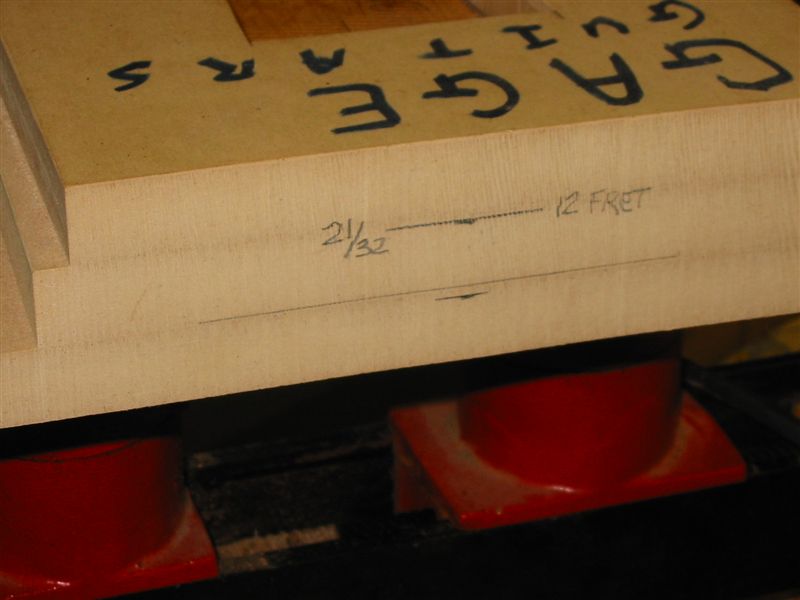

I set the router bit hight here on the outside of the jig.

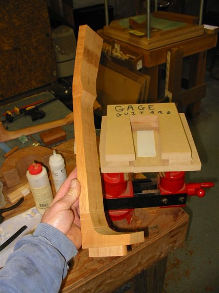

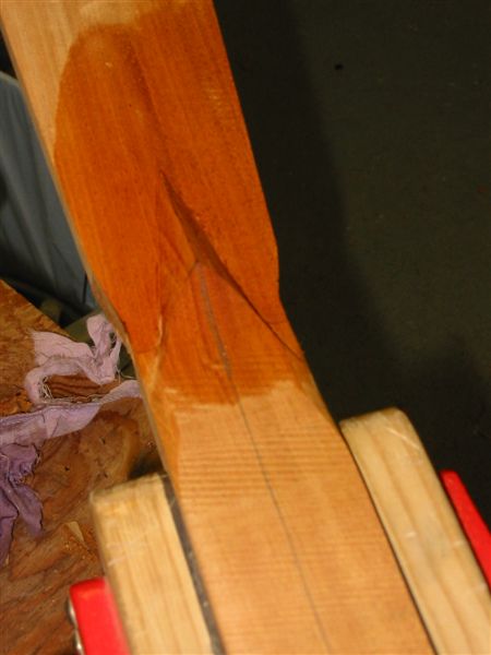

Now heres where you need to be carefull, I route the whole back of the headstock and up to the lines of the volute "free hand". I get as close as possible and then clean up the lines later with my chisel.
there is still alot to do on this to clean it up... but you get the general idea.

Matt, the cap is off your glue! Its going to DRY UP!
Great little jig there! Man I gotta get me one of those vices!
How do you center it in the jig? I see the two sided tape that holds it in place.

Matt, great tutorial.
Lance, looks to me like square top of headstock for alignment, and the part that is left high for the volute acts as the centering guide.
PostPosted: Sun Jul 22, 2007 2:00 am
Oh, I see.  The guide is as big as the headstock at the top, so just put it in the middle.  The only reason for the wider bottom portion is the so the wider top will slip through, but when it is in, the guide follows the sides of the headstock, otherwise you couldn't route to the edge.

actually there is no guide, the top section is just roughly the shape of the headstock.
the actual headstock is narrower, and there is about 3/8" clearance all the way around it.
the jig is really just for flattening the back of the headstock and roughing out the lines of the V.

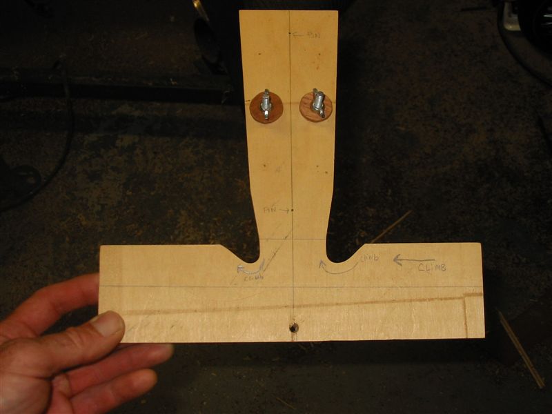

I shape the outline of the headstock on a different jig that looks like this:
on this one, the jig follows the bearing bit, and cleans up my rough bandsaw cut.
it only trims off a little bit of material, and leaves me with a nice 1 3/4" nut width.

Hi Bruce, I`m using a 3/4" straight bit with a flush bearing under.
i use this same bit for almost everything.

In this picture, what is the paper used for in the picture? Is that double sided tape to hold the neck in place? If it's not double sided tape, how do you hold the whole thing still for routing? TIA, Bruce

[QUOTE=Matt Gage]The neck is held down by using double stick tape. Matt[/QUOTE]
I missed that line between the photos, but did see the white tape in your jig. Makes sense. Thanks Matt. bd

the router definitly leaves you with some sanding to do after. i try to make random passes with the router so there are no distiguishable straight lines that are hard to sand out.
