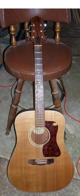

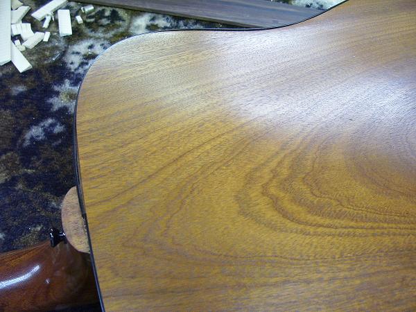

Anyway, I reglued this plastic binding on with LMI's FCA contact adhesive. Everything went well with the glue, but I have a couple spots where I removed the tape and some of the finish came too. Not all of the finish, but it left a light "shadow". That brown paper binding tape has some major stickum. I should have stuck it to my shirt a couple times to weaken it.
This picture is from before the fix.
It's a Guild dred with a so-called hand rubbed finish. Does anyone has a guess as to what the finish might be? It's a thin, very low gloss finish.
I was thinking I could pad on a little tung oil, and very lightly go over the whole surface to blend.
Thanks so much,
Horton, MI
PostPosted: Wed Jul 18, 2007 1:58 am
Hey Kirt!
I'm not sure what the finish is, but if this was a westerly, R.I. Guitar it is worth a small fortune. I would make real sure of what the finish is before I put anything else on it.
As you probably know, Guild was bought out by Fender guitars a good while ago. You should be able to get the answer you require by contacting their customer relations department at
Telephone: (480) 596-7195
Fax: (480) 367-5262
E-mail: consumerrelations@fender.com
Be sure to include the serial number with your correspondence with them.
Hope this helps!
PostPosted: Wed Jul 18, 2007 2:11 am
Posts: 493
Thanks, Ken & Todd,
I will try to contact Fender. This is the only picture I have here at work. I'll post one of the "effected area" tonight.
Looks like I'll be doing a bridge re-glue on this too. Had to check with the owner, he didn't know it was pulling up. He said go ahead, so I will probably replace his leaning plastic saddle with a bone one.
This is all freebee work so I can get some repair experience. But I still want to do it right.
Horton, MI

PostPosted: Wed Jul 18, 2007 11:21 pm
Posts: 493
It's a D4HR. From what I found they started making them around 1991. Don't know if that makes it a Hoboken or a Westerly. It's heavily built and would make a good starter instrument. Can't say much for the tone, but the strings look as old as the guitar and the bridge needs major work.
Haven't had a chance to contact Fender yet.
Horton, MI
