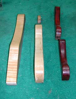

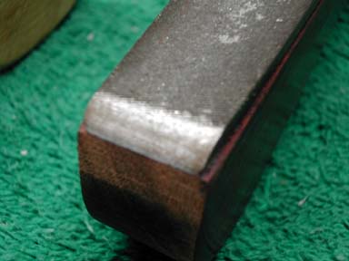

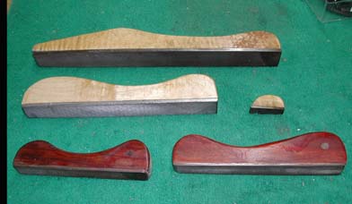

Here are some of my homemade fret leveling files. I cut the tangs off with a grinder and epoxy the file to a nice hardwood block that I've trued up over the jointer or with a hand plane.
The big one on top is a mill bastard file and that's my go to file for initial leveling.
The shorter maple handled one is a double cut file that I made up for leveling out bar frets. It your best friend when you need to remove a lot of meat and you don't have all day.
The two red handled files are mill smooth files and I use them mostly for cleaning up after the bastard cut and for beveling the fret ends. (Those are bubinga handles if anyone is curious.)
The little tiny guy I use for beveling the first four frets on the top side of banjo necks, pesky fifth string bump always gets in the way. It's also really nice for spot leveling inlay dots.
I like to round over the tips of thee files to minimize and bumps and dings that they can put into the frets if the nose dips down while filing.
