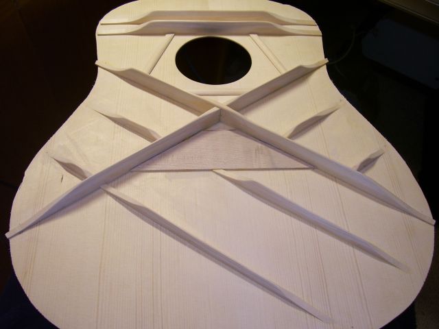

I have just weighed by braced soundboard minus the bridge at 328 grams. It is Adi with Adi bracing and maple bridgeplate. I was wondering if anyone could tell me if this was somewhere around useable or still too heavy. It is for a dred sized guitar. I know the question is a little like how long is a piece of string but I would appreciate some comparisons with others that keep track of all the details.
Regards
Craig.

A little more info on the top. It is 16 inch lower bout 20 inch length.I have thaken it down  to .115 inch thick. I have left the top flat ,no radius . The bracing is all 1/4 x 3/4 inch except the bracing between the sound hole and neck join which is 5/16 x 3/4 inch.
Thanks for the reply's.
Craig.

Craig, is your bracing 3/4" tall everywhere?
PostPosted: Thu Jul 19, 2007 4:48 pm
Joined: Wed May 30, 2007 4:29 pm
Posts: 188
Jim the main x brace and the 5/16  braces are 3/4 tall .The main tone bars and smaller braces are about 1/2 inch tall.
regards
Craig.

PostPosted: Fri Jul 20, 2007 12:46 am
That is very neat work. That's the first time I've seen a tone bar originating from the center of the bridge plate rather than from the X-brace. Interesting.
PostPosted: Fri Jul 20, 2007 1:52 am

Thanks Hesh for your encouragement and explanation of tap tuning.I will give it a try. Ron the bracing layout I got from a picture that Rod True posted on the forum a while back. He based it on Jim Olsen's design. I really like the sound of Olsen guitars so thought I would give it a go.
Regards
Craig.
