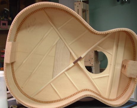

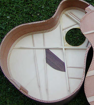

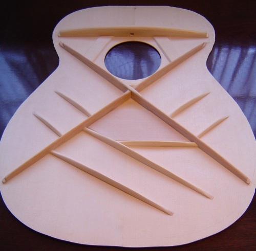

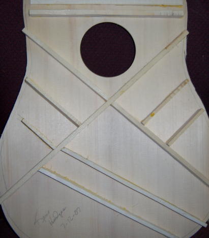

They say pictures are worth a thousand words, so here is a visual on what I am talking about:
In the first two pictures, notice that the tone bars are attached to the X-brace leg very close to the intersection of the "X" and are so long that they had to be tapered to nothing in order to miss the kerfed bracing when the top was attached:
Now this next picture is one of my tops that is fresh out of the clamps and hasnt been cleaned up, shaped or sanded yet, but you can see that the tone bar is much further from the "X" intersection and will miss the bridge plate by a good way.
I realize that these are all different styles of guitars, but I am wondering what effect, if any, moving the tone bars closer to the bridge plate would have?

It is really hard to say what effect moving the tone bars closer will have without knowing what is going on with the rest of the top. The whole structure is a system. The effect of changing one component will vary depending on the effect all of the other components are having.
If the top plate itself was somewhat flexible across the grain compared to the stiffness along the grain, you might be better off with the tone bars closer to the bridge. That will do more to enhance the cross grain stiffness in the areas where it is needed the most. It will also do less to enhance the effect of the long grain stiffness by moving the braces closer to the long dipole node line which runs across the top right behind the bridge.
If the top is really stiff across the grain it might be better to move them down a bit so that they influence the long dipole more and the cross grain stiffness less.
Changing the angle based on the stiffness ratio of the top also works well. Point them in the direction that needs more stiffness.
On my tops, I try to get a sense of the stiffness ratio of the top and then change EVERYTHING a little bit. Top thickness and graduation, bracing position, bracing angles, bracing dimensions...... to try to get the whole top to have a certain "balance", and  to behave in a way that has proven to work well for me in the past.

First, what Mark said. It's a system, and all has to work together; changing one thing usually calls for changes somewhere else. Thus, _every_ system of tone bar placement works for somebody, and doesn't work for somebody else. There is no magic anything.
I heasitate to put this in, because it's very tempting to take it as a simple overarching truth, and hence to misconstrue. Still: I tell my students that the point on the top at the centerline at the upper edge is all structural, and has nothing to do with tone. The point on the centerline at the bottom edge is all about tone, and has nothing much to do with structure. The ratio of structural to acoustic importance varies depending on how close you are to those two points. The tone bars, being behind the bridge, have much more effect on tone than they do on structural strength, and the further down those bars you go, the less they are 'structral' bars and the more they are 'tone controls'. PLEASE don't let me hear in some future discussion that 'Al said that you could make the top tissue thin at the tailblock because it has no structural role'. This all has to be taken within reason, and follow 'accepted practice', even if at some distance.
Several years ago now I made a 'matched pair' of guitars, with the only difference being the tone bar placement. One had more or less 'standard' tone bars (or, at least, my version of it) and the other had a double-X brace. I took them to the ASIA meeting that year, and had a lot of other makers play them, without telling them what the difference was. There was a small, but definite (about 2:1), preference for the double-X top, even though, as one builder said when told: "But that doesn't WORK!". And that builder prefered the double-X!. Sure, one test, even when well-controlled, doesn't mean a lot, but it does suggest that 'alternative' tone bar placements can be made to do the job.
I was working on the theory that the 'free' plate mode shapes partly determine the assembled tone, and used the double-X to facilitate getting the shapes I want. Other people have different notions, and follow different paths to realize what they consider to be the 'desireable' end. But it comes back to seeing the top, and the guitar, as a system, and figuring out the role of the different parts in relation to that.
