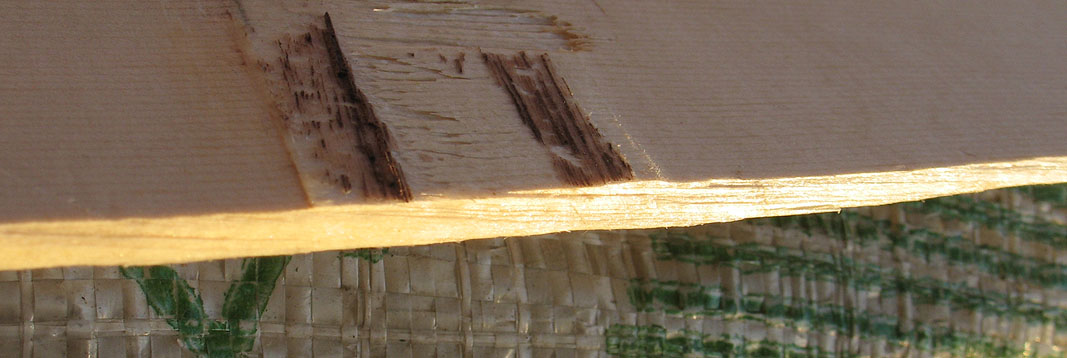

Is this a rather serious runout or what.
Pictured, the top of my first guitar. It didn't have much volume, and it wasn't getting any better after i thinned it on and on. I removed the back and put stronger braces and that didn't help either. In the end I decided to remove the top, and split it to check the thickness. (except bridge footprint and edges, mostly 2mm and under)
The picture isnt that good but I think it can be easily seen that the fibers are only 1 inch long.

that is rather extreme runout and unless it was expressly sold as low grade wood i would be letting the vendoe feel my displeasure.
that being said i don't think that would on its own account for your volume problems.

Thanks Michael...at least I have learned a bit more now.
It is Eng., sold as "fine grade" =AAA, not a 10$ board and I also paid for joining. Oh well, I hope I'll have better luck next time.
For the volume, I should add that it was a treble problem. It had pleasant tone and nice bass when plucking softly, but no treble headroom if I would want to play a forte passage.
Since I bought an expensive wood, I simply assumed it is very stiff, so I thinned a lot.  From what i have read, stiffness is good for trebles, runout is bad for stiffness, and in the end my top felt quite soft between the braces indeed.

I would rather not put it out openly - everyone could do a mistake, and duds can slip easily especially with non-homogeneous materials such as wood.  It is also my fault that I didn't know better - and since I have used it I can't complain anymore.

From what I have learned so far, SS builders do not seem to mind runout nearly as much as classical builders. Romanillos for example (Shawn's posts), plus the couple others I have talked over email, will not use anything but zero runout.  Is this simply a sort of tradition, or a way to make sure the wood sustains a heavy shock better without splitting, or does it really have a tonal importance?
It would be very interesting to learn what is the difference in
stiffness between a top split perfectly on the quarter, with full
length fibers, and a top cut slightly skewed.
I am still trying to blame the low volume trebles of my classical on the severe runout of the very thin method of construction I tried.  I shoudl add that at first it was closed up thicker, maybe 2.5 -2.6 mm for most of the top. It had more treble volume, but it was tight sounding, could barely do a vibrato for example.

Alex, I think all you have to do is send your vendor the picture you posted above. I can't believe that anyone could defend that wood as AAA--that's some SERIOUSLY short grain! You're right, mistakes can happen, and that board might have been sorted on a Friday at 4:30pm. Contact them and see what they say.

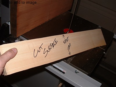

This picture is of a bit of wood left over from cutting soundboards. I split the sides and to show face runnout.
I try to make cuts as parallel to the split face as I can. Of course I have never seen a billet or bolt split so straight that you could run a straight edge on it over 26 inches.
That aside, I am still curious about the picture above, because it looks like a split showing side grain, but not face(unless I am just mistaken. Which is very possible ).

Yes the drawings in the thread show the issue quite well. The only difference is that in my image the fibers rise and exit the board from right to left and in the drawing from left to right.
