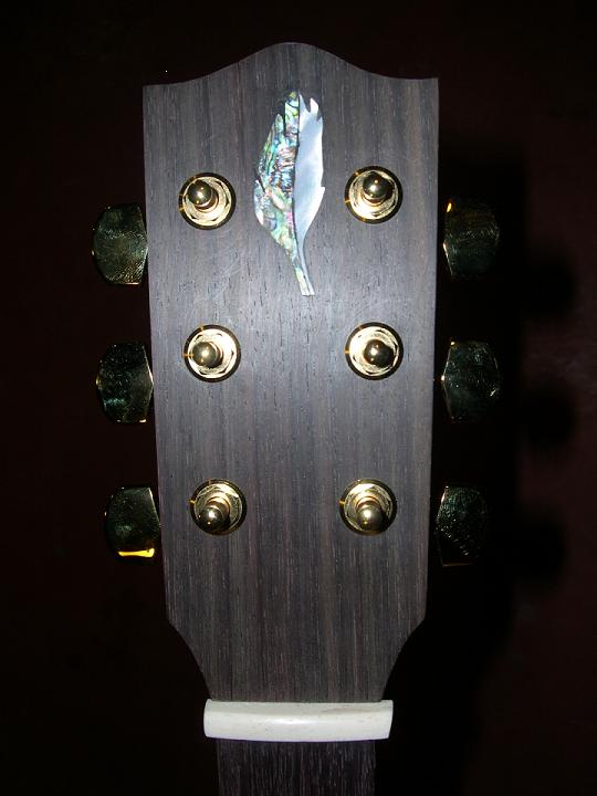

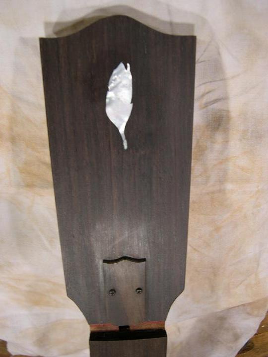

I've done both ways but prefer the access to the truss rod via the headstock. For me this makes it easy for final set-up and any future adjustments.
I basically exit the channel via the headstock as so.
Here are 2 images with and without a cover.
Michael Lloyd

Should have been.
Michael Lloyd

Great photos Michael.
I have a question about the screws if I may.
Are they screwed into wood or are there some sort of inserts that they screw into?
If they're screwed into wood, do you ever have issues with the the holes wearing out?
Blain

I just pre-tap the holes than tighten to finger tight. Not much pressure at all. As fore wearing out I've haven't had any issues. I generally don't have a reason to take the cover off that often maybe once every 2 - 5 years and only if the truss rod needs adjusting which maybe never.
There are some interesting covers pics in the archives. I particularly like the no screws one.
