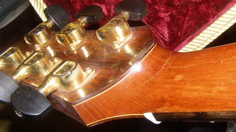

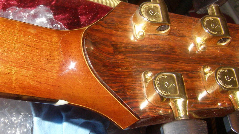

I just got this back today from having the fingerboard repaired - it was separating from the neck shaft. I noticed it after I bought the guitar and the seller had me send it to his repairman right away. The repair is great but the shipping company tried to kill my guitar this time. Thank goodness they didn't succeed - it looks like they stood the shipping box on it's end and let it fall on it's face - headstock whiplash!!! The shipping box and the inside of the guitar case were packed immaculately.
The pictures show the crack thru the short grain at the headstock/neck join. The guy who sold me the guitar about had kittens when I told him. He and the repairman are bending over backwards to get this fixed so I can get this guitar back very soon. Joe Heumiller at Dream Guitars sold me the guitar and Bill Tippin is going to fix it again. Both are great and I feel bad for them - I know both are as frustrated about this as I am.

The shipping box was stood upright on it's end (lower bout) and knocked over flat on it's face - the weight of the headstock is enough to separate itself from the neckshaft upon impact with the ground. I work at the Atlanta airport and have seen guitars destroyed with little effort. I work within 100 feet of the local Fedex, UPS, ect. shipping centers and see how packages are treated. It's scary.

it is very easy to believe it can happen after you have repaired 50 or 100 the or so. what you describe is common, and illustrates why it is necessary to pad the headstock to stop the whiplash.

I bought a 12 string from an eBay seller that had this happen.  The repair was easy with the strings off and slightly speading the crack and applying StewMac's thin CA (#10??) and then clamping lightly.  The hard part was restoring the finish over the crack......
