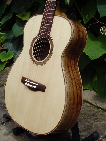

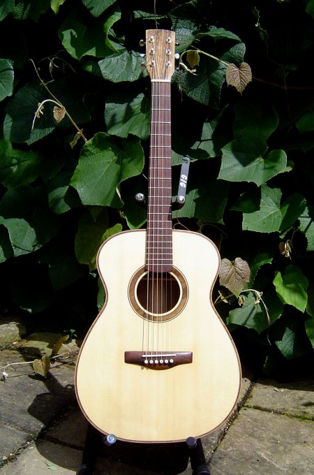

Well, I’ve finished my latest guitar an Italian Spruce/English Walnut OM. This one has been made specifically to be played in DADGad and some of the other altered tunings. It’s very much in my style, I like to keep all of the woods in the same colour palette, so this may be a bit retrained for some. Dave described it as ‘Lowdenesque’ which is good enough for me.
Top: Italian Spruce from Luiggi
Back/sides: English Walnut
Binding: London Plane, with bookmatched English Walnut and ebony/pear/ebony purfling
Neck: English Cherry (as is head and heel block)
FB and bridge: Madagascan rosewood
Rosette: English walnut with ebony/pear/ebony purfling
Nut/saddle/bridge plate laminate: Camel bone
Finish: French polish, of course.

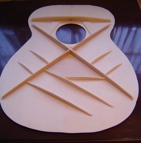

As you would expect from me the top is ‘parabolic’ braced as is the X-braced back. It uses my normal bolt on neck with fingerboard glued to a neck extension which floats

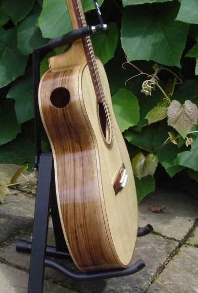

Is that the first one you've done with a soundport? What do you think of them? I really love them. Did you Tru-oil the neck in the end or FP it?

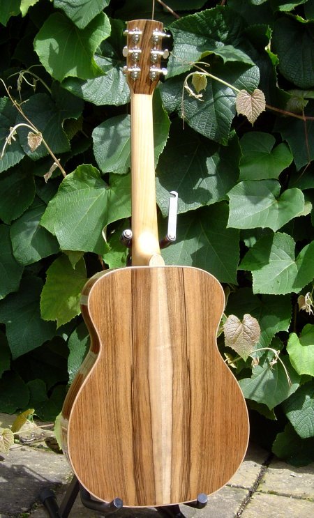

A total beauty! Where did you source the walnut?

How did you arrive at that port hole size?

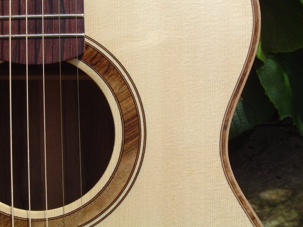

The color of that English cherry is remarkable. Looks nearly like a light mahogany, or dark maple. It matches the sapwood in the back perfectly.
AND---is that a double line of walnut in the purfling?

Dave, yes it's the first soundport I've done from scratch, though I have retro-fitted one to a couple of earlier guitars, I like the effect enormously. The thing I like about you Dave is that I get comparison to Lowden and Richard Thompson in one posting! Life doesn't get much better. Yes, True oil on the neck, following your programme.

Steve, the English cherry has become my favourite neck wood, it's a little denser and heavier than mahogany but seems to add a lot of controlable sustain. the pics didn't really bring out the beautiful range of colours in the cherry. No, binding is London Plane then the purfling is Walnut ebony/pear/ebony.

I wanted to ask you about your bracing. The ends don't taper much and I am curious about how you get the excellent bass notes. Could you possible give their maximum height and thicknes, and the thickness of the top around the soundhole.
I thought I did a porpoise style brace profile, but mine is really not much like yours at all.
