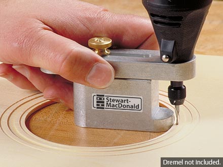

PostPosted: Wed Jun 27, 2007 6:53 am
Somthing like this should do the trick
PostPosted: Wed Jun 27, 2007 7:39 am

Ya, the great thing about that tool is the unobstructed view.
Nice one Michael!

PostPosted: Wed Jun 27, 2007 8:45 am
Posts: 1106
Location: Amherst, NH USA
Michael,
I considered that tool but my ovals are really small. I said about 2"x 3" earlier but they are more like 1-1/2x2-1/2. The Stewmac jig wont fit. If there was one with about a 1" base on it, it might work but it might be too tippy.

PostPosted: Wed Jun 27, 2007 8:47 am
make your own that will fit from rock maple
PostPosted: Wed Jun 27, 2007 8:52 am
Posts: 1106
[QUOTE=MichaelP] make your own that will fit from rock maple [/QUOTE]
Worth considering. What are the thread specs on a dremel? I recall that they are somewhat unusual.
