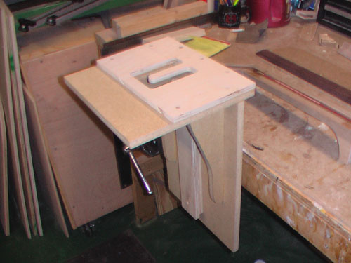

I'm a relative newbie here, actually just finished my first build and am in the stringing up/tweaking stage.  I don't claim to have a wealth of experience, but this worked well for me!
Attached (hopefully) is a pic of the jig I made for routing my neck joint.  The entire top of the jig is removeable, held in place with dowel pins.  With the template off, I clamp the neck blank in vertically to the long piece of plywood in the center (fretboard area facing OUT), which is angled 91 degrees to the top of the jig to allow for a slight back-angle when mated to the mortise.  I just flush-cut this with the router, then add the template and rout the U-shaped tenon.
I have a similar jig for routing the mortise, the closed body clamps underneath the jig in the same way and the matching U-shape is the actual template on top.  Hope this makes sense!  if not, holler and I'll snap some pix of the body jig as well.

I would like to see your body jig if you can post a picture of it. I have been considering doing something new with the neck joints and you may have the solution.

REALLY COOL.
Could you show off some pics of the block jig too, and when you use it again, some pics of it in use. That looks simple enough

Hiya!
This cuts an exact slot to match the jig in my previous post.  I pre-drill the neck block for the two machine screws and truss rod adjustment, close up the body.  Then I just match the body's centerline with the one on the jig's top, clamp it down, and cut the slot with a few passes of the router.  In my case, I do this prior to binding.  Then just test-fit the neck and sand accordingly, mark the screwhole/trussrod locations from inside the body with a tapered punch and drill the holes for the inserts.
Hope this helps, sure works well for me!
Jon

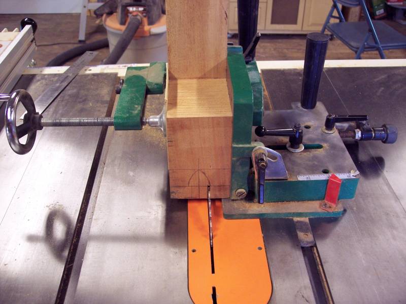

As for tenoning I use my table saw with a tenoning jig.  It is the same kind of jig you use for making tenons on furniture.  Here is a picture of mine. One piece of advice I learned the hard way, lay out your tenon, drill and install the brass inserts before cutting the tenon.  The sides of the tenon are fairly weak and can (will) split very easily while installing the inserts.   I got this at Woodcraft and it is pretty inexpensive.  I also route the mortise in the block before installing it.  I use a 3/4" mortising bit and my router table with a fence.  I am much more comfortable cutting the mortise on an expendable block of wood than taking my router to a guitar with expensive sides already installed!

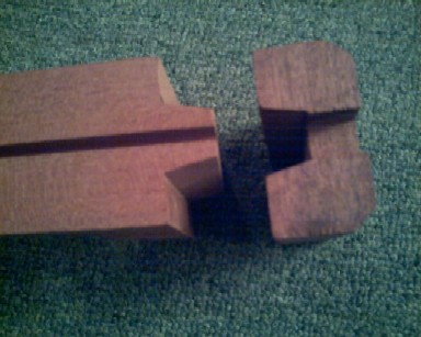

At ASIA there I bought a couple of Mossman necks and neck blocks more because they had an interesting joint. It's a M/T with beveled sides. Hope the picture shows.

Well an EDIT button would be nice. I don't know if Stu Mossman used this joint on all of his guitars but I like the looks of it. I might try this on a future build.
