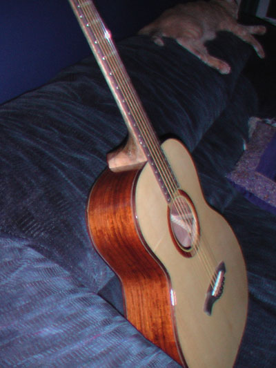

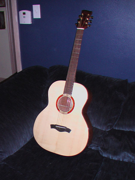

Whew!  Here's my first ever, in all its glory.  Building this guitar was a great experience, the learning curve made not so steep thanks to the members of this forum.  You guys all are absolutely super, I love the open exchange of info and ideas here.
Special thanks to my "almost neighbor next door" Bob Long for answering my many questions along the way.  I saw the Pheasant guitar in the Z-poxy stage...that guitar is beautiful, Bob!

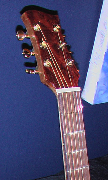

Let's see...what I'll do different next time...smear the Z-poxy across the grain like the directions say, then sand most of it back off!  Couldn't see the high spots until I shot the first coat of lacquer over it.  Will also not mount the tuning machines backwards....doh!.....and I'll press the frets in before glueing the fretboard, thanks again to insights I've gained from this forum.
It's granadillo, sitka, mahogany/walnut neck, red morell burl headplate, padauk/maple/walnut rosette, RW binding, mahogany bracing throughout.
Thanks for looking, will post a sound clip up soon.  Man, I gotta say this thing sounds beautiful!  Very resonant and FULL of harmonics...suprising low end.  Happy happy happy!

hey jon, that is an impressive guitar! i really like the headstock and veneer. did you mention what the fretboard material is? also cool looking bridge. good job man!

Good looking guitar Jon. You'd have to be happy with how it turned out.
I like the look of the nude fingerboard.
The cat doesn't look that impressed though

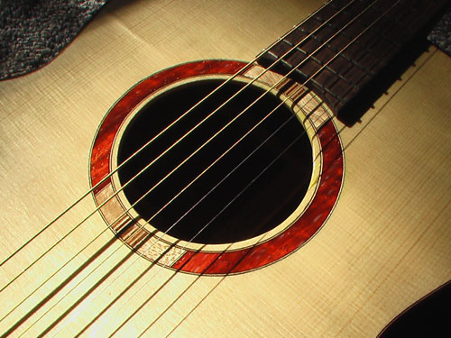

Great job Jon! I especally like your headstock and that
padauk rosette is very cool!

Well done!  Love the rosette and HS veneer.

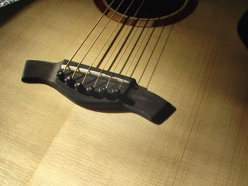

[QUOTE=BobK]Well done Jon, and nice choice in materials too. How about giving us a closer look at your rosette and bridge? Both look very nice.
BobK[/QUOTE]
Thanks, Bob!  Here's a few closeups, although my photography skills aren't anything to brag about....

PostPosted: Tue Jun 26, 2007 2:31 am
Great guitar for a first!!
Nice bridge too!

Very cool Jon! I'm really proud of you!
I love the bridge! I'm crazy about the rosette, I'm manic about the morell!!!   AND... I can't wait to play it.

PostPosted: Tue Jun 26, 2007 3:02 pm
Nice work, Jon! I like the way you handled your rosette, making it look good for the whole 360 deg. So, why the short fingerboard?
