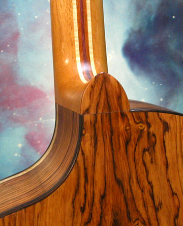

First let me say that I don't do cutaways, never found the need for one. But I think to really make them look right and function as intended, the neck must seemlessly flow into the body. I was hunting the archives but can't find the thread I was looking for but this is the look that I mean. This one is by Wade Sylvester, a builder whose take on design I really like. I hope he'll come in here and give more details.
